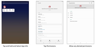

App Permissions
The App requires permission to access your camera, the file storage system, and the location of the device (GPS). The App will prompt you to give access to these items when it first needs to access them. Failing to give these permissions to the App will mean it cannot function correctly.
If you have accidentally denied any permissions, you can enable them using the 3-step process outlined in the images below.
