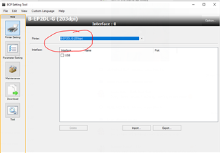

  5. Select the correct printer model from the 'Printer Setting' view (see image) and wait a couple of seconds for the tool to find the printer

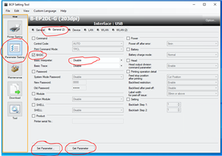

  6. Select the 'Parameter Setting' view (see image).
  7. Select the 'General (2)' tab.
  8. Select the 'BASIC' checkbox, and then click the 'Get Parameter' button. This will then retrieve the corresponding setting from the printer – so should display 'Enable'.
  9. Change the selection to 'Disable' and then click the 'Set Parameter' button.
  10. Press and hold the Power button on the printer to switch the printer off.
  11. When the printer is switched back on, it should be in 'ON LINE' mode.
