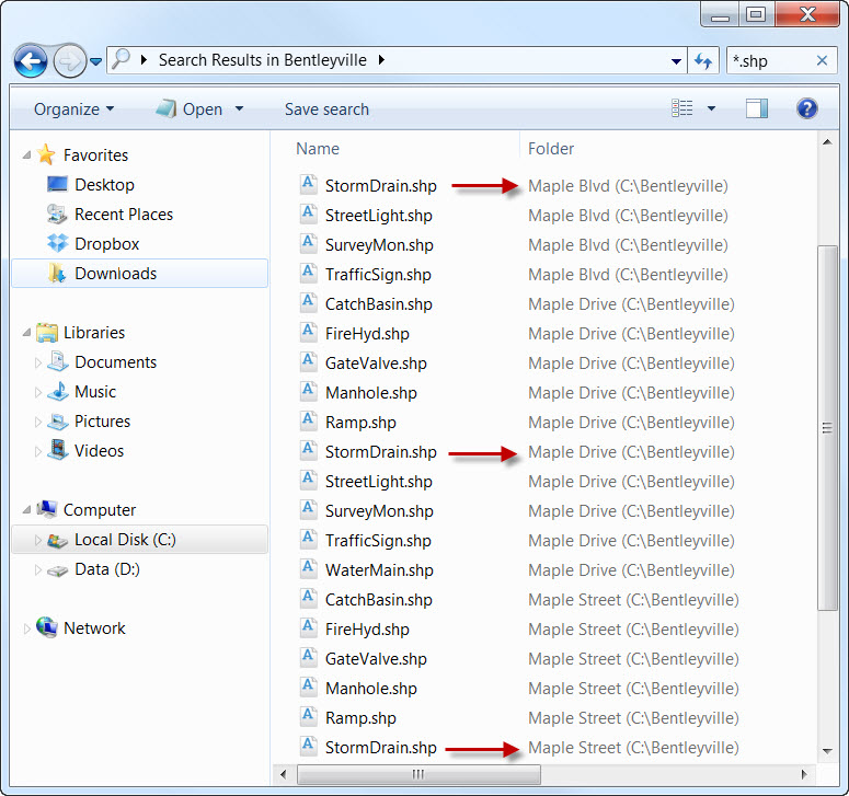

Let's suppose that a municipality is doing a field audit on items such as fire hydrants, catch basins, traffic signs and more.  The data collector captures the location and related attributes on a street by street basis and uploads this data at the end of every day to a central server where it will be accessed by OpenCities Map users.  In this example dataset, folders named Maple Blvd, Maple Drive and Maple Street all have the same named shapefiles.
As already mentioned, the Map Interoperability dialog only allows a single directory to be imported at a time. And while this will work in a pinch, it's certainly not efficient for bulk importing of data that's spread over many folders.  To deal with bulk importing of data, let's take a look at using the GDI key-ins which are part of core OpenCities Map.

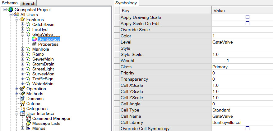

The symbology of the incoming data can be specified by the gdi import keyin or by feature definitions in the project schema.  If you're using the project schema, the import will be somewhat slower.  Also note that feature names can not contain spaces or dashes which may require remapping to accommodate the names of the Shapefiles.  There is a command line option for doing that.

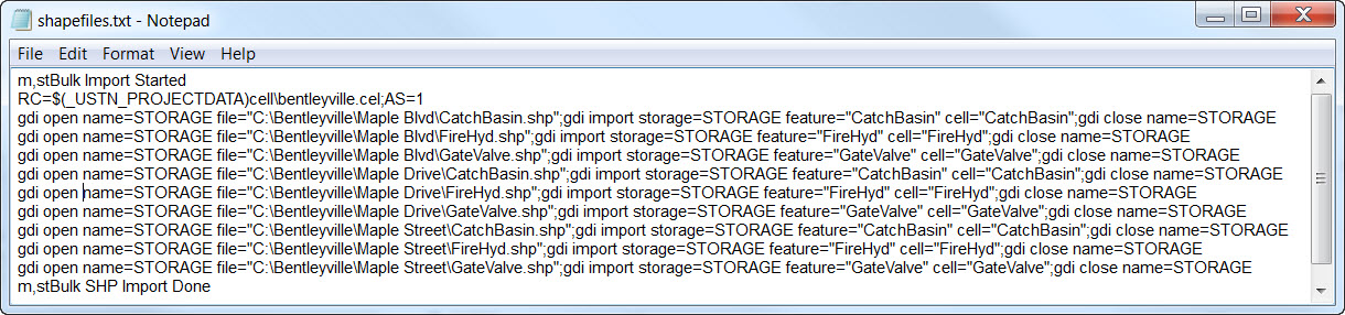

To create the script, get creative with DOS and perhaps EXCEL.   For example, these four keyins will produce shapefiles.txt that's ready for importing. (Run them one at a time, the "for..." command does not work inside a BAT file.)
echo m,sBulk Import Started > shapefiles.txt
echo RC=$(_USTN_PROJECTDATA)cell\bentleyville.cel;AS=1 >> shapefiles.txt
for /f "delims=," %a in ('dir /s /b *.shp') do echo gdi open name=STORAGE file="%~a";gdi import storage=STORAGE feature="%~na" cell="%~na";gdi close name=STORAGE >> ShapeFiles.txt
echo m,stBulk SHP Import Done  >> ShapeFiles.txt
The contents of the resulting text file are is as follows.  Notice that the name STORAGE is defined for every Shapefile, then imported and immediately closed.  This is a terrific solution for dealing with hundreds of folders, and while it does run a bit slower, it requires zero user interaction.
