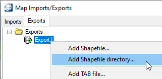

- Right-click on the Exports node. Select New Export
- Right-click the export node and select the Add Shapefile... option. Navigate to an output folder and enter a file name

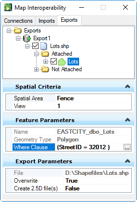

- Expand the Attached node and ensure your feature is selected

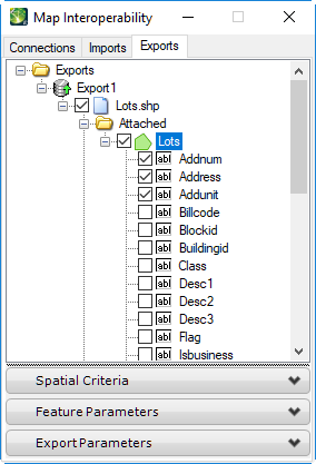

- To specify which properties to export, right-click the feature and select Show Properties > Ungrouped.
- Refine your export by defining the Spatial Criteria, Feature Parameters and Export Parameters:
- When done, right click the export node and choose Export.
- To export multiple features at one time use the Add Shapefile Directory... option
