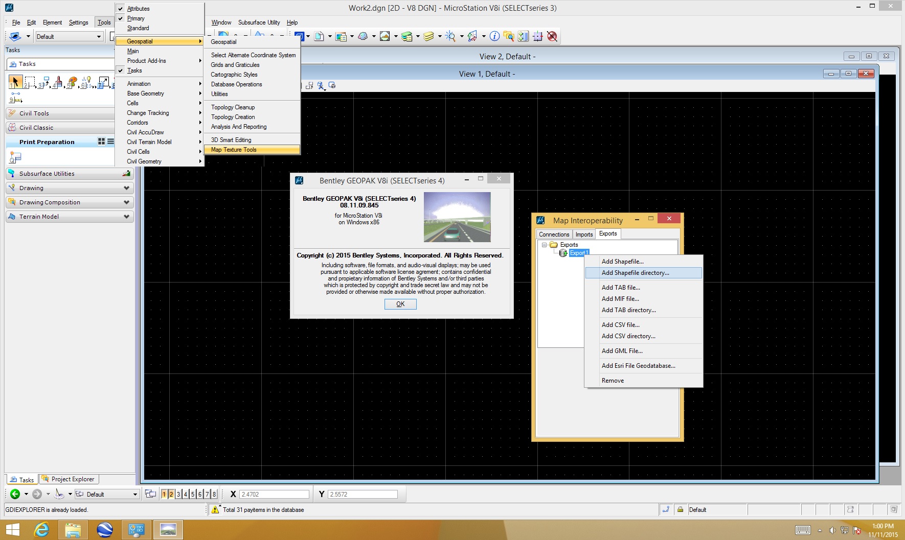

- Activate Map using GEOPAK V8i (SELECTseries 3) 08.11.09.772 crashes
Selecting  Activate Map in GEOPAK V8i (SELECTseries 3) 08.11.09.772 results in a crash.  We have seen this problem occur when GEOPAK V8i (SELECTseries 3) is combined with MicroStation V8i (SELECTseries 3) 08.11.09.654.
The solution is to upgrade to a later version of GEOPAK.  The GEOPAK software upgrade requires that you also upgrade to MicroStation V8i (SELECTseries 3) 08.11.09.714 or higher.
GEOPAK V8i (SELECTseries 4) 08.11.09.845
