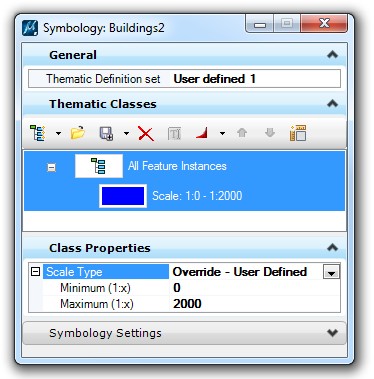

To specify the a scale range in the Map Manager, select Symbology from the features right click menu.
In the feature Symbology dialog, set the Thematic Definition to one of the three User Defined options.
In the Thematic Classes pane, expand Class Properties and turn off the From Feature Definition option.  Then proceed to set the minimum and maximum scales as needed.
The result is immediate.

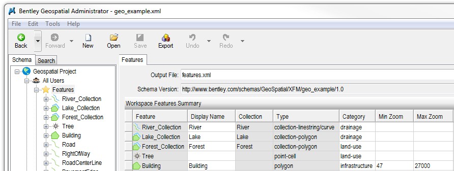

If you prefer, you can define the default visible scale ranges as part of the feature class definition.  To do that, set the  Zoom Min and Max options in the Feature Definition tab in the Geospatial Administrator.  This will take effect for new feature queries or for newly placed features.
