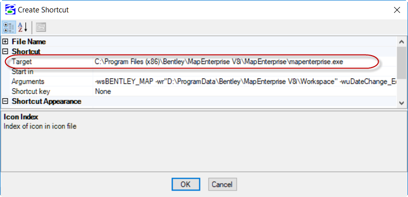

- Shortcut Target path
The default paths for the shortcut targets are noted below.
Bentley Map V8i Standalone -
C:\Program Files (x86)\Bentley\MapStandalone\V8i\MapStandalone\MapStandalone.exe
Bentley Map V8i for MicroStation -
C:\Program Files (x86)\Bentley\MicroStation V8i (SELECTseries)\Microstation\ustation.exe
Bentley Map V8i Powerview -
C:\Program Files (x86)\Bentley\MapPowerView V8i\MapPowerView\mappowerview.exe
Bentley Map V8i Enterprise -
C:\Program Files (x86)\Bentley\MapEnterprise V8i\MapEnterprise\mapenterprise.exe
OpenCities Map Powerview -
C:\Program Files\Bentley\OpenCities Map PowerView CONNECT Edition\MapPowerView\MapPowerView.exe
OpenCities Map Advanced -
C:\Program Files\Bentley\OpenCities Map Advanced CONNECT Edition\MapAdvanced\MapAdvanced.exe
OpenCities Map Ultimate -
C:\Program Files\Bentley\OpenCities Map Ultimate CONNECT Edition\MapUltimate\MapUltimate.exe
