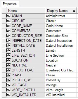

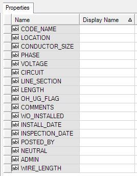

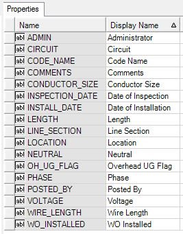

Similarly, Property Names can have an alternate Display Name which makes it better suited, and easily recognizable than the original Property Name.
Compare the two summaries, before and after defining a Display Name:

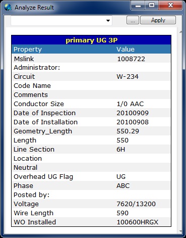

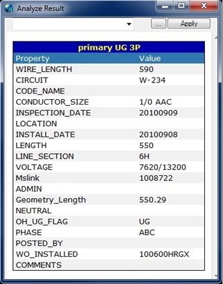

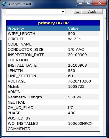

Display Names provide a way to make the Feature Name readable. This is especially apparent when reviewing Features using the Analyze Feature command in OpenCities Map.
Compare the two Analyze Results, before and after defining and ordering by Display Name:
You can Sort By Display Name and get these results by modifying the default.xslt file that is delivered with OpenCities Map, and adding the line:

Now each time you use the Analyze Result, the list will be alphabetized and sorted by Display Name.
