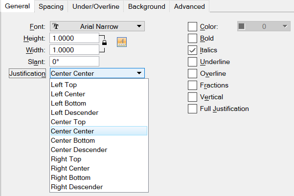

Text Justification sets the position of text relative to its origin. MicroStation supports all justification types for both single-line and multi-line text.
Text Justification is used only for text whereas Text Node Justification is used only for Text Nodes.

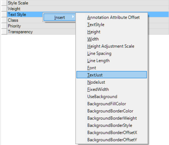

Text Justification is set in the Text Style that's defined as part of the text feature symbology.
This setting, as with the other text style settings, can be overridden by inserting a new key:
Note:  New settings will be created with a default value of 0 for the criteria and won't be considered.  Set the criteria value to blank or 1 to ensure it will be used.
