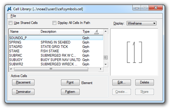

  1. In your cell library, create a new (non-annotation) type cell containing a single text string with "[1]" characters such as shown in the following. Please note that during feature instance creation the Property Based Annotation subsystem will replace the "[1]" characters with appropriate business property values defined with a standard PBA expression.

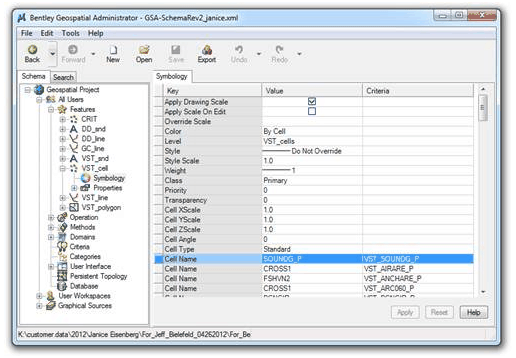

  2. Add a new "Cell Name" symbology key for your new cell to your schema, defining any applicable criteria as shown here:

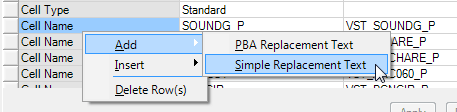

  3. Add a new "Replacement Text" symbology key as shown here:

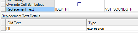

  4. Choose the new "Replacement Text" symbology key and define the appropriate PBA expression and criteria as shown here:

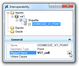

  6. In the Interoperability application, redirect the incoming feature instances for your import to the target feature class using the "Mapped Name" property as shown here:

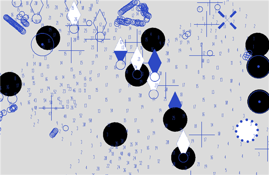

  7. After import, instances of your target feature class will consist of point-cells with either symbols or text as shown in the following:
