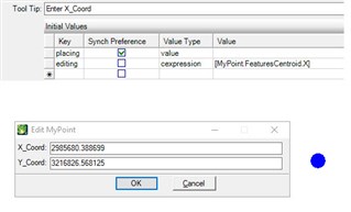

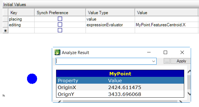

Geospatial Administrator has a number of built-in XFM feature properties that can be incorporated into the feature property definition.  For example, you may want to place or capture the origin coordinates of a point feature.  In that case, you would use the FeaturesCentroid.X , Y or Z property that's built-in and available to use.
Point Feature Origin:
Calculates the X, Y or Z coordinates of the point feature.

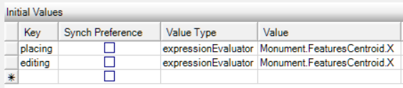

Key = editing,  Synch Preference = OFF
The following will be triggered after the feature has been placed, and the Edit mode has activated.  An alternate approach is to create an annotation sub-feature which automatically triggers the Edit key for the calculating the feature property.  Or, use the Sync1 MDL application that enables editing keys to auto-update anytime the feature is modified with Map or MicroStation.  Refer to:  Auto update editing initial values (Sync1)
Value Type = cExpression
Value = [FeatureName.FeaturesCentroid.X]
Value = [FeatureName.FeaturesCentroid.Y]
Value = [FeatureName.FeaturesCentroid.Z] - For 3D only
