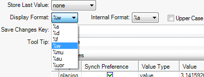

Setting the desired amount of decimal precision in the Analyze XFM Feature Results dialog box can be accomplished in the Geospatial Administrator's property Display Format setting.  This field allows you to choose between seven different types of formats for the results:

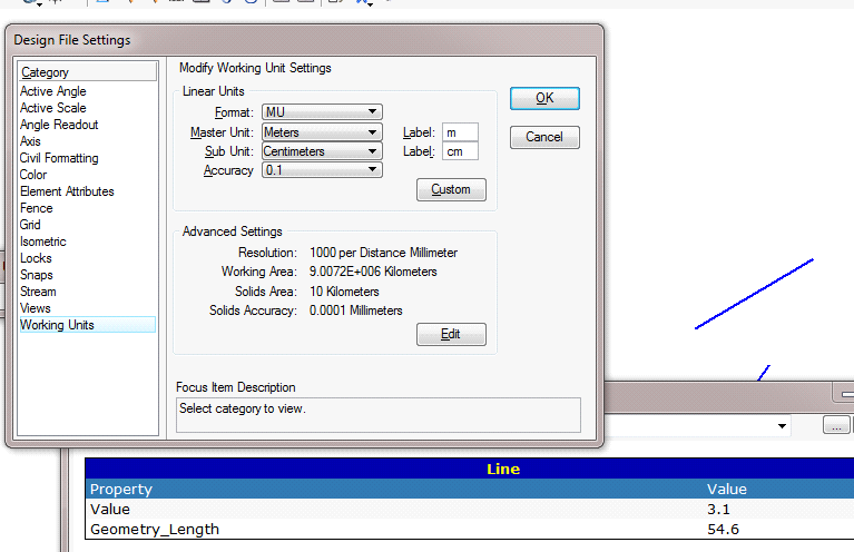

Using the %w option, in association with the MicroStation Design File Settings, Linear Working Units Accuracy field, you can adjust the decimal readout in the OpenCities Map Analyze Results dialog box from zero to six places of accuracy.
