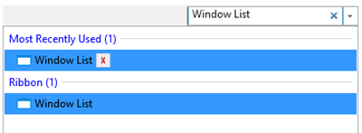

Use the Ribbon Search (F4) to search for 'Window List', and select the tool.
Note: Hovering over the list item will display pathways to access the tool via the ribbon interface
