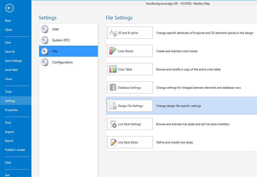

2. Initialize OpenCities Map or MicroStation and select the Design File Settings option from the File menu.

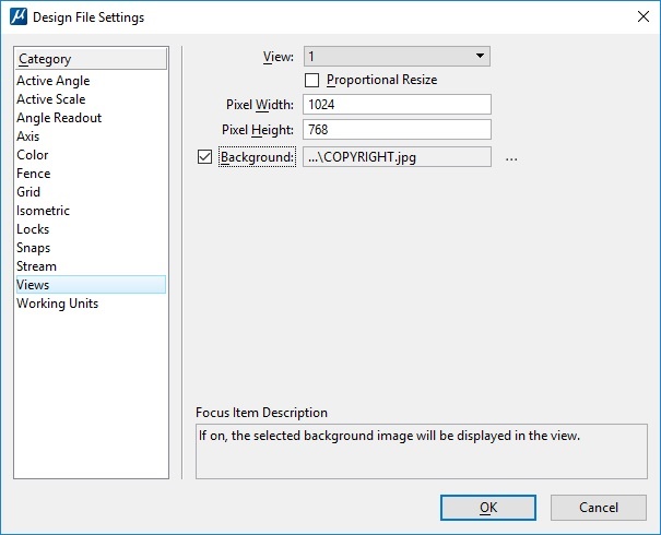

3. Select the Views category in the Design File Settings. Browse for the image file you created in Step 1 and enable or check the Background option:
Select OK to apply the settings and exit the dialog box.

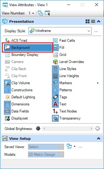

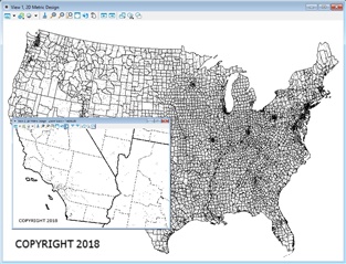

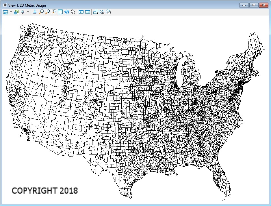

5. Return to the DGN file and select View Attributes dialog box (use the keyboard shortcut <ctrl>+B to open the dialog). Enable the Background option and check to see that the watermark is displayed in the lower-left corner of the view. The image remains in that position as you use the view controls to zoom in, zoom out, & change the view scale. To turn the watermark off simply toggle the Background option in the View Attributes dialog.
View 1 with copyright watermark:
