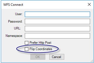

WFS 1.0.0 servers specify the axis order for geographic coordinates as longitude/latitude (X/Y). WFS 1.1.0 and 2.0.0 servers specify the axis order as latitude/longitude (Y/X). This may result in queried features being rotated or flipped. To avoid this, enable Flip Coordinates during attachment.
Note:  When Flip Coordinates is enabled in the WFS Connect dialog, it will be applied to all WFS connections in your current design session.  To clear this option from your design session you must restart Map.
