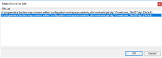

In the event that the feature class is attached in multiple reference files, a dialog will open prompting you to select the correct file.  This is typical when your data is organized in map tiles covering a large geographic area.
