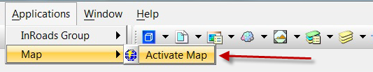

For InRoads, InRoads Suite, Rail Track, Rail Track Suite, & MXROAD, the Activate Map item is located in the Applications menu

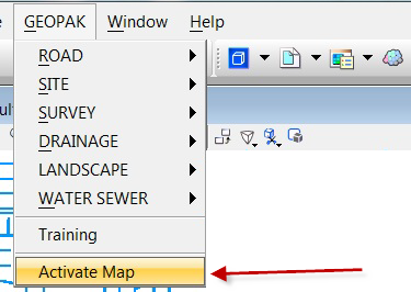

For GEOPAK, GEOPAK Engineering Suite, PowerGEOPAK and other GEOPAK applications, the Activate Map itme is located the GEOPAK menu

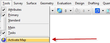

For Power InRoads and PowerCivil for 'Country', the Activate Map item is located in the Tools menu
