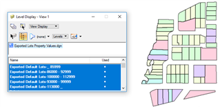

Note: Each element class will be on its own level. The level names start with "Exported"  followed by the <model name> and <feature class name>. With the VBA renameLevelsAndModels.mvba (in the attached ZIP file renameLevelsAndModels.zip) all the levels can be renamed quickly, e.g. strip the string "Exported" and the model name from all levels. Once the VBA is loaded, open the dialog Replace String in Levelnames with the keyin Vba run startReplaceStringInLevelNames
