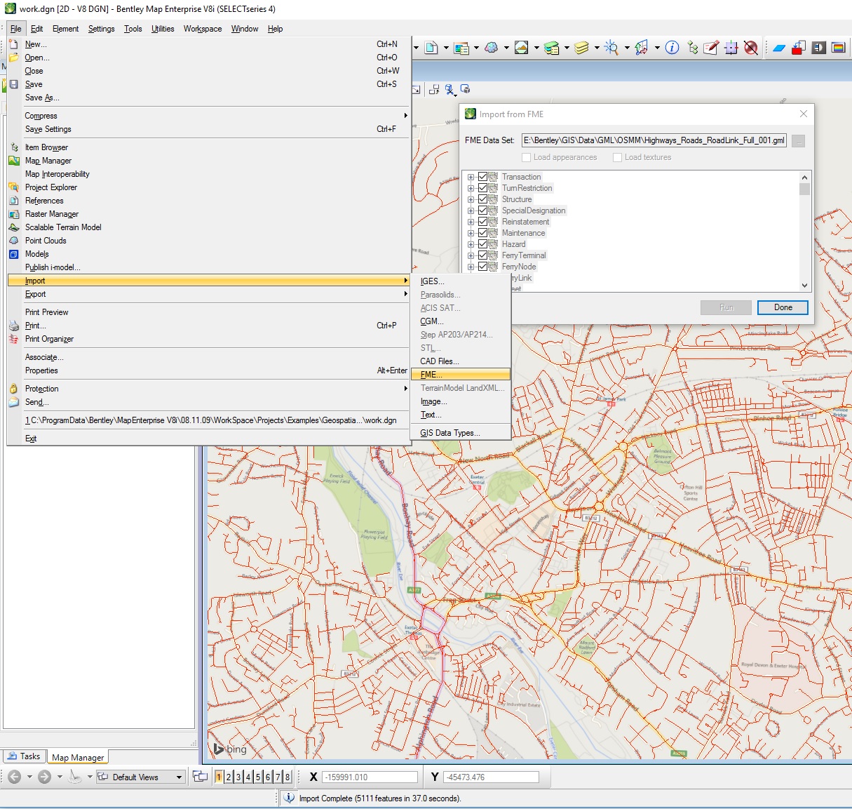

When the schema is missing, or present but not well-described the data may not import properly. This is apparent in the messages that are returned from the Import command. Some examples are shown here:
Exception: The 'http://www.w3.org/XML/1998/namespace:lang' attribute is not declared.
System.Xml.Schema.XmlSchemaException
System.Xml.Schema.BaseProcessor.SendValidationEvent(XmlSchemaException e)
The FME Interface is accessible through the File | Import | FME menu item, as-shown here in the V8i menu:
For OpenCities Map, use the File | Import | Geospatial File Types | FME Import option
This short video shows the comparison of importing an INSPIRE-formatted GML file using the Import GML file command, vs. using the same file with the FME Interface:
