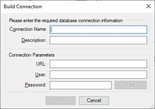

When defining a graphical source as an ArcGIS Server connection in OpenCities Geospatial Administrator, the Build Connection dialog provides additional options.
Connection Name – The name of the graphical source. This is reflected in the OpenCities Map interface.
Description – An optional description
URL: – The published address of the ArcGIS server.
User – The ArcGIS Server username
Password – The ArcGIS Server password
