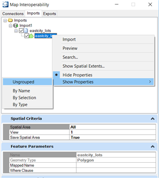

1) In OpenCities Map CONNECT Edition, go to File> Import > Shapefiles
Browse to the location of your Shapefile and select the Shapefile> Click Done
2) Map Interoperability dialog opens, under the Import Node you will see the Shapefile that you selected
Right‐click on the feature, and Select Show Properties> Ungrouped.

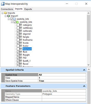

3) Expand the feature to display all associated properties and uncheck the properties that you do not want to import with the feature.
4) Right-Click on Import Node and select Import to start the process.
The Shapefile is imported in Active DGN only with the checked feature properties.
