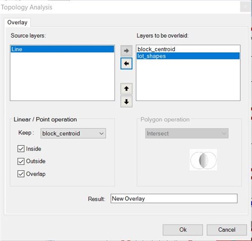

When one of the layers to be overlaid is a point layer or a linear layer, the Linear / Point operation section of the Topology Analysis dialog box is activated, as-shown below.
In the Linear / Point operation section, you must select the feature you want to keep in the overlay output layer: the points or lines, or the polygons.
There are three selection criteria for point/ line‐to‐area overlays: Inside, Outside, and Overlap.
These criteria may be enabled individually or in combination. Each type of operation will have different results.

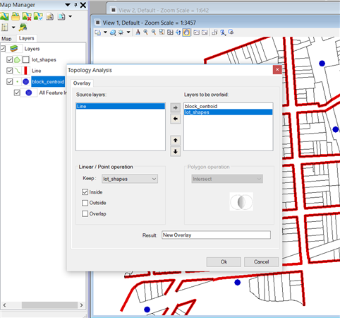

Steps to perform Point/Line to Area overlay analysis:

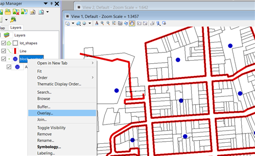

 1) In the Map Manager, Right-click on the point layer and select Overlay
2) The Topology Analysis dialog opens, and the selected layer is automatically added to the ‘Layers to be overlaid’ list on the right side of the dialog box. Now use the arrow buttons to select the Polygon layer.
3) Once the Point and Polygon layers are selected, the Linear/Point operation will be activated. In the example shown below, the following options were set:
Keep: Lot_Shapes (Area Layer) – Select the layer for output geometry
 Inside: enabled
 Outside and Overlap: disabled
4) Type a name for the overlay in the Result field, and select the Ok button. The new Feature is added to the Map Manager Layers list.

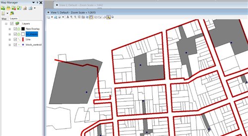

Results are shown in this example – the Overlay Output layer in Grey has returned all the Lot_Shape containing the Block_Centroids.

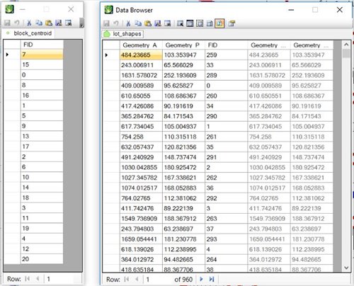

                                                                          Data Browsers of individual layers
                                               Block_Centroid                                  Lot_Shapes Feature Properties

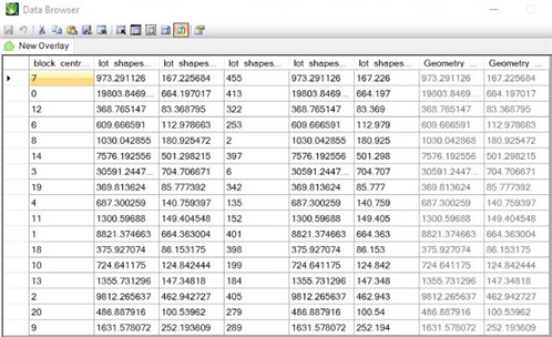

                                       After Overlay- Data Browser of the Output Overlay Feature with combined properties
