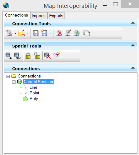

Inside the Map Interoperability dialog, select the Connections tab.

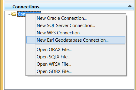

Right-click on the Connections folder and select the New Esri Geodatabase Connection… option.

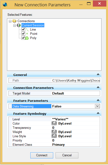

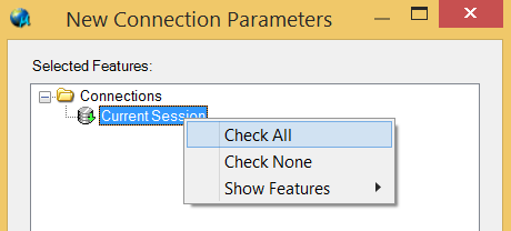

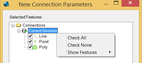

Right-click on Current Session to access a list of options, including to Check All or None of the features and to choose how the features will be shown.
Edit General, Connection Parameters, Feature Parameters and Feature Symbology as desired.
Select ‘Connect’ to establish the connection.
