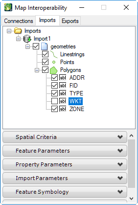

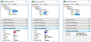

Opening the VRT file in as an Import in the Interoperability dialog allows you to specify the Spatial Criteria, Feature Parameters, Import Parameters, and Feature Symbology.

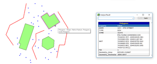

When imported, the resulting graphics are native features with business, geometric, and WKT properties.
If the WKT properties are not desired, disable them in the Import node using the Show Properties > Ungrouped opton.
