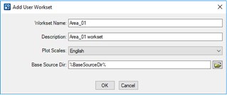

When Tools > Options > Expand Variables is OFF, the variable will be visible in the Workspaces Root Directory:

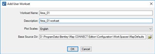

When Tools > Options > Expand Variables is ON, the full path of the folder defined by this variable will be shown:
%BaseSourceDir%  which points to .../Configuration/WorkSpaces/MapDefaults/ and defines the location of your workset source files.
Note:  When you save a new project XML file, it will either save the variable or the full path.  This is determined by the state of the Expand Variable option.
Note:  Changing the Expand Variable option on existing projects will only change the display of the Workspaces Root Directory and Base Source Dir fields in the Geospatial Administrator.  To write those changes to the XML file, do a File > Save As.
