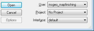

Start > Programs >Bentley > Bentley Map Enterprise V8i > Advanced Map Finishing.Bentley Advanced Map Finishing is started through a custom workspace delivered
With Bentley Map and Bentley Map Enterprise. Select the Msgeo_mapfinishing Work space as shown.

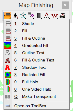

To use the Bentley Advanced Map Finishing effects tools, open the Functions Toolbox from the Map Finishing tool frame.
Click on Function tools it should display list of list of commands.
Also enable WYSIWYG on the Map Finishing menu; this re-symbolizes elements to Show Bentley Advanced Map Finishing effects that have been applied to them.

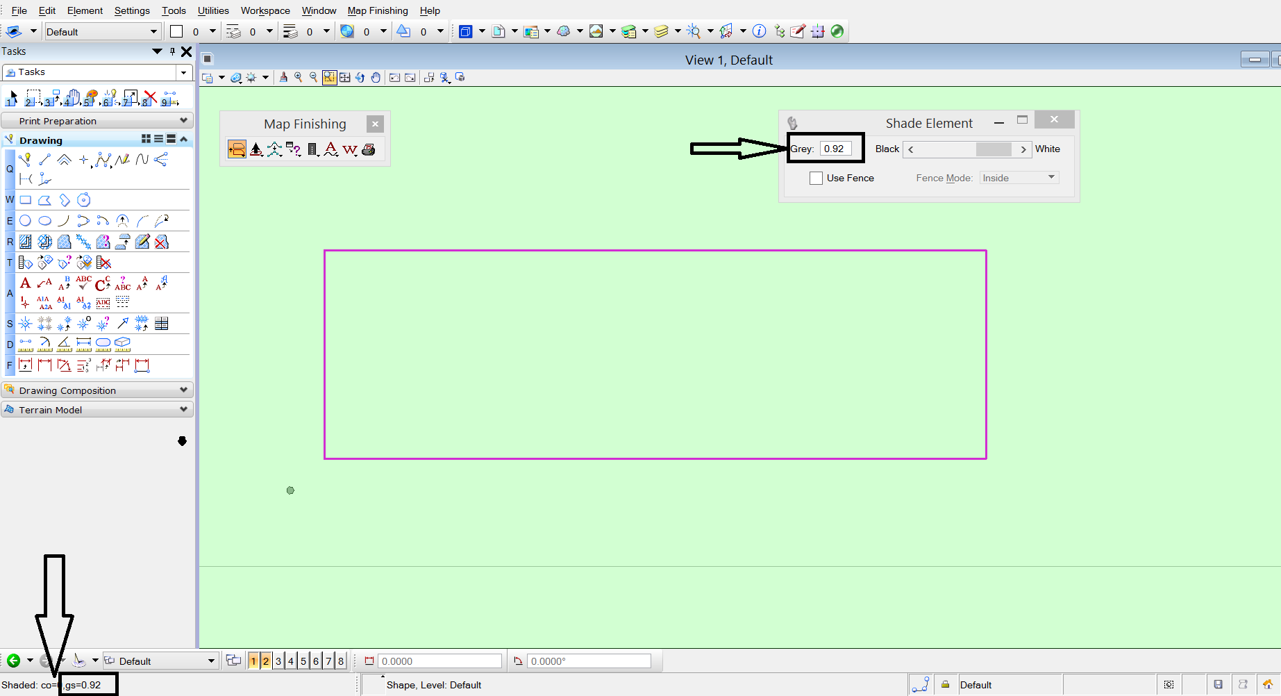

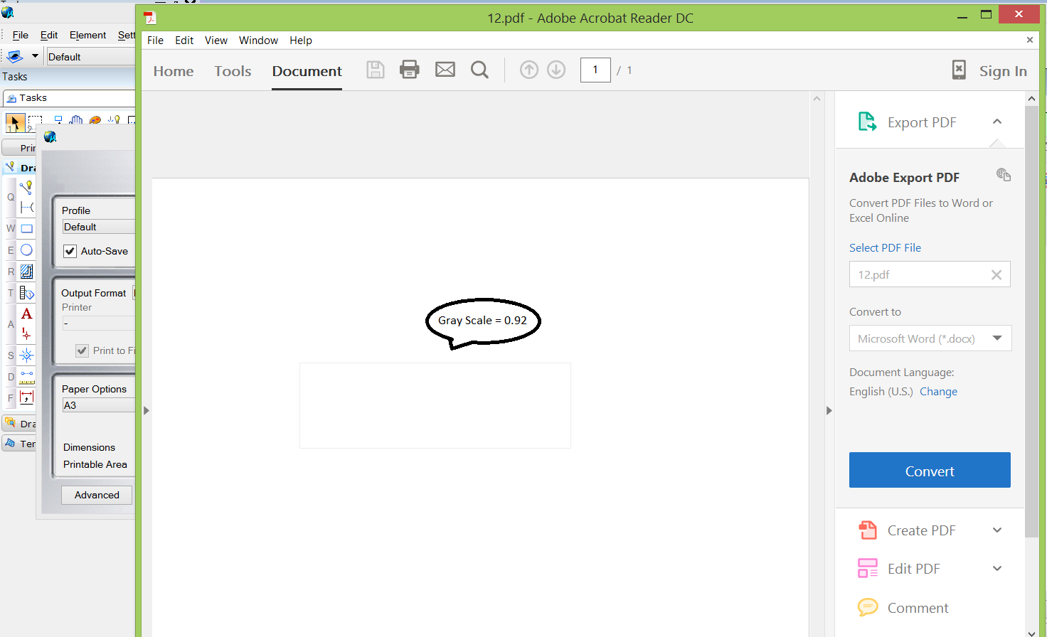

 1.   Shade
 It Shades an element with a gray scale. It’s used on text elements.It should work on Microstation text, but not on FlexiText element.
-> Open .dgn file with some shape elements.
-> Select the Shade tool from the Functions toolbox
-> In the tool settings window :
-> Identify the element(s) to be shaded. (It should only work on outline of shapes like circle, polygon etc.)
-> Accept the change.
-> In status bar check the confirmation prompt with gray scale (gs) and color value (co) assigned in shade dialog.
Note: The shade attribute does not display on screen, it only appears on the print output. When you print shade attribute, the Monochrome toggle must be turned ON in the Advance print dialog in the Output tab.
                                                                    Print document with Gray scale defined

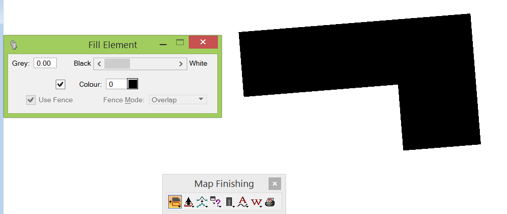

2.   Fill Tool
Opens the Fill Element settings window which is used to fill an element with color and/or gray scale shading. Fill dialog is similar to Shade Tool with one added functionality i.e. Color. It is used to define the fill color setting. If the color item is not selected then the element is filled with its current color.
 To Fill an Element
-> Select the Fill tool from the Functions toolbox.
-> In the tool settings window, define the settings you want to apply.
-> Identify the element(s) to fill.

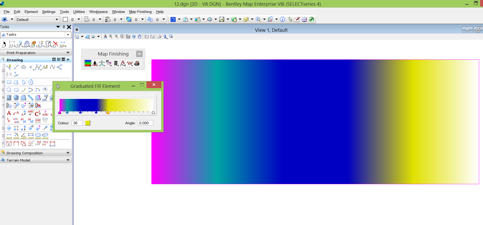

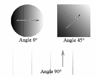

4.   Graduated Fill tool
The Graduated Fill tool fills a closed element with a smooth variation of color from the start color to the end color. The direction of the graduations is determined by the angle specified.
Note: Text strings, but not text nodes, can be plotted as graduated fill but do not appear on screen as filled.
To Fill an Element with Graduated Fill
 -> Select the Graduated Fill tool from the Functions toolbox.
->  On the Graduated Fill Element dialog, click the color button and change the color.
-> Double click on the scale at 50% to add another color indicator and change the color.
-> Set the Angle.
-> Select the element and confirm with a data point.

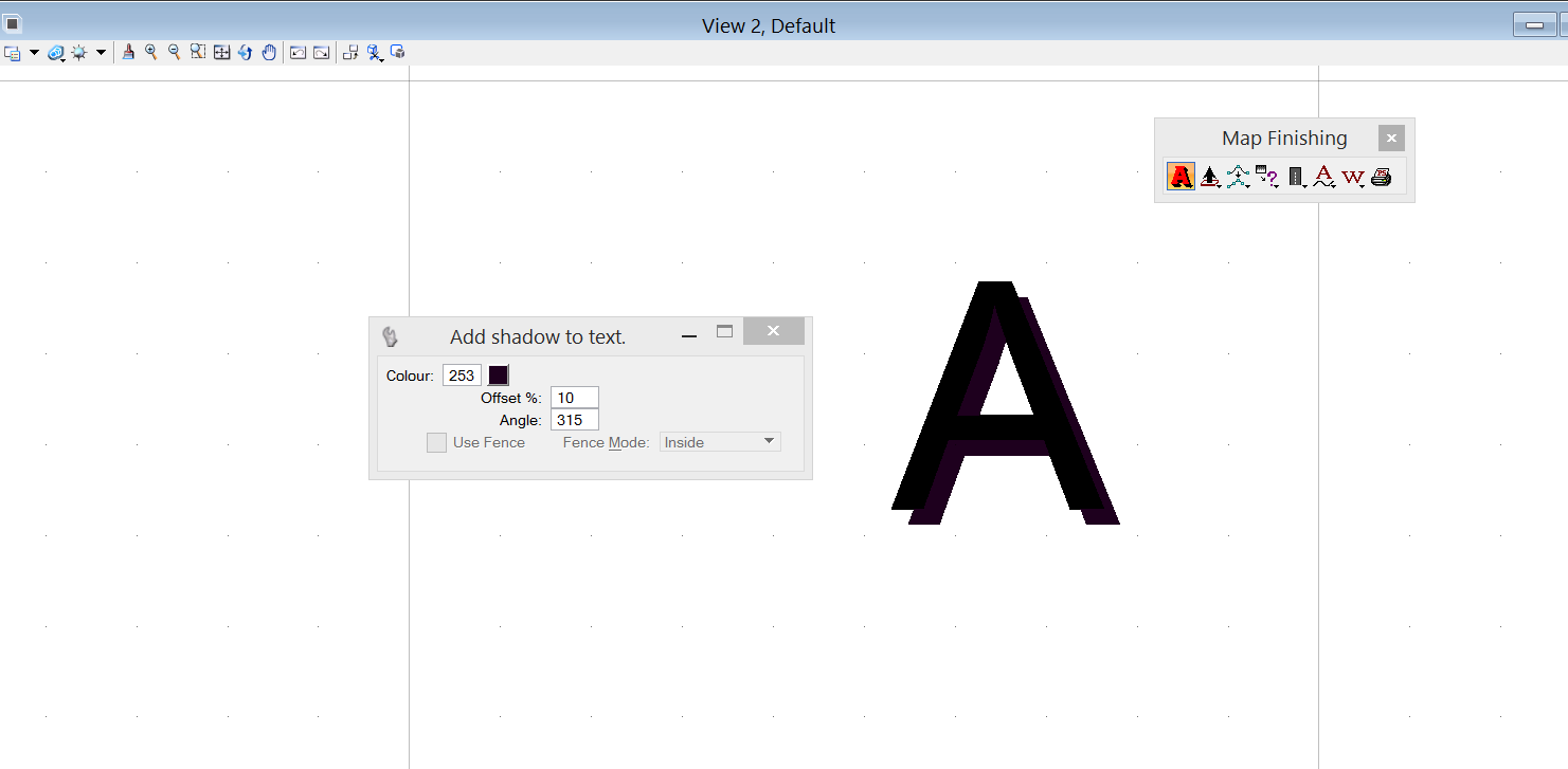

7.   Shadow Text tool
 It is used to add a shadowing effect to a text element.
-> Open the SHADOW dialog, change Color, Offset, and Angle.
-> Select the Text element and confirm with a data point.

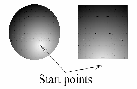

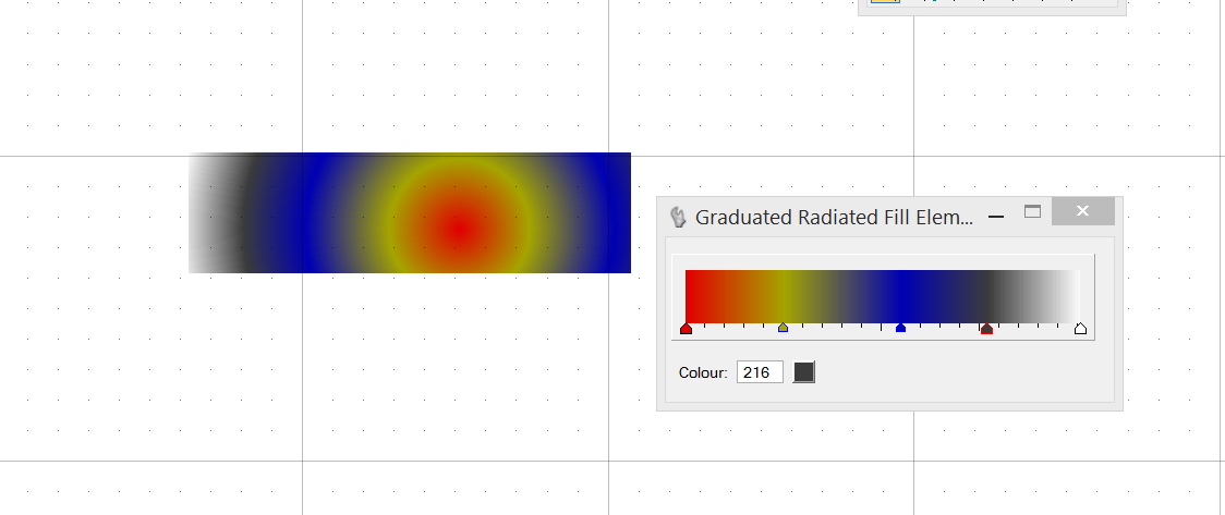

8. Radiated Fill
 The Radiated Fill tool fills a closed element with a variation of color from a start point to the furthermost point within the element. After selecting the element to apply the fill, a second data point defines the start point.
Fill an element with a radiated fill
-> Open the Graduated Radiated Fill Element dialog.
-> On the Graduated Radiated Fill Element dialog, click the Color button and change the color.
-> Select a circle element and define the start point inside the element with a
-> Data point at the top center of the circle
-> Select a different circle and define the start point at the bottom right of the circle
-> Select a third circle and define the start point in the center of the circle.
Notice how the appearance of the fill differs based on the start point defined in each circle.
                Notice how the appearance of the fill differs based on the start point defined in circle.

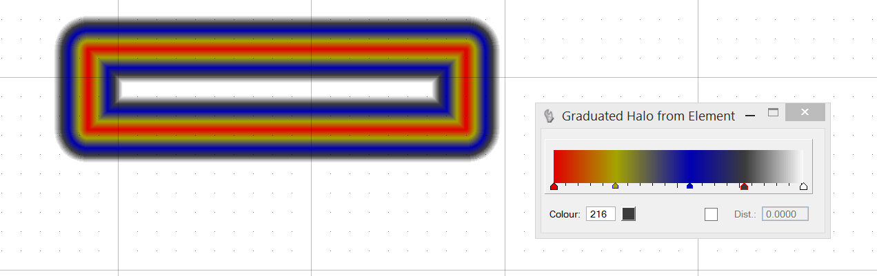

9.   Halo
 The halo tools generate a graduated halo around an element, starting at one color and ending in another at the specified distance from an element. A full halo can be produced on both sides of an element.

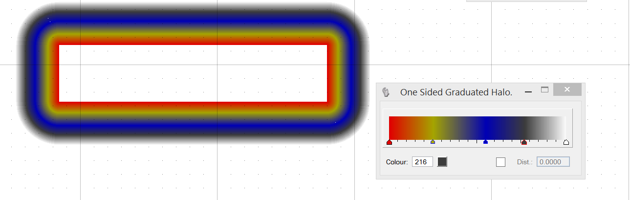

10.  One sided Halo
The One sided halo tools generate a graduated halo around one side of element.
