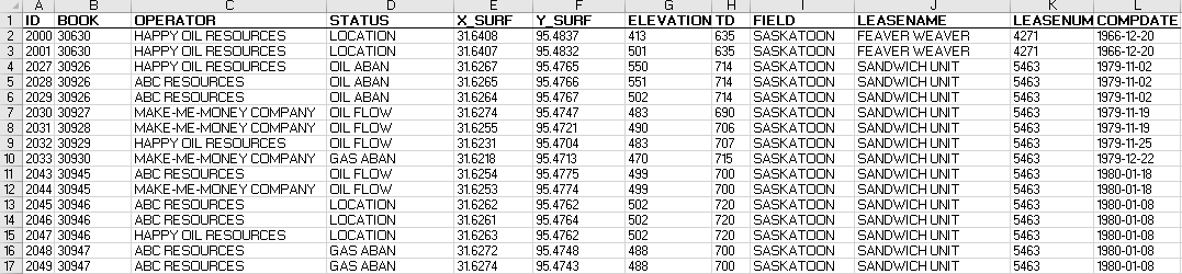

In this example the Excel file contains location and property information for wells:
ID, BOOK, OPERATOR, STATUS, X_SURF, L_SURF, ELEVATION, TD, FIELD, LEASENAME, LEASENUM and COMPDATE.
