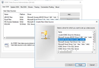

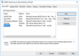

After installing the Access Data Base Engine, you can then create an ODBC data source using the ODBC Data Source Administrator (64-bit)  which is can be found in the following location:
C:\Windows\System32\odbcad32.exe
Finally reinstall your 32-bit Office product.
(To avoid installing the Microsoft Access Database Engine 2010 Redistributable package, simply upgrade your Office to 64-bit versions.)
Once the ODBC definition has been created, you can proceed to use it with OpenCities Map.

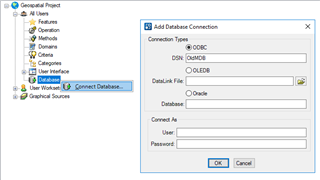

From the Database node, create a new database connection.
The database is read and the tables found in MSCATALOG are displayed in the Overview tab.

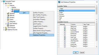

Create a new feature and add database properties:

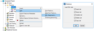

Add SQL statements to keep the records in the database current and synchronized with the geometry in your design files.
If needed, remove the reference to MAPID from INSERT and COPY.  For example, this:
INSERT INTO building (MAPID,MSLINK,buildingID,heatType,bldgType,occupClass) VALUES ([XFMGetMapId],[buildingMslink=XFMNextMslink("building")],[buildingID|NULL],'[heatType|NULL]',[bldgType|NULL],'[occupClass|NULL]')
Becomes this:
INSERT INTO building (MSLINK,buildingID,heatType,bldgType,occupClass) VALUES ([buildingMslink=XFMNextMslink("building")],[buildingID|NULL],'[heatType|NULL]',[bldgType|NULL],'[occupClass|NULL]')
