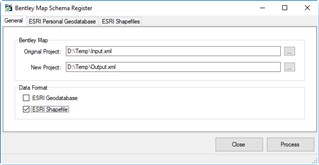

Create and save a new empty schema using the Geospatial Administrator.
Run SchemaRegister.exe from any folder.
In the General tab, set Original Project to the input xml created above.
In the New Project field, type in the name of the output xml that Schema Register will create.
Select the Data Format as either ESRI Geodatabase or ESRI Shapefile.
In the ESRI Shapefiles tab, specify the folder containing the SHP files and associated DBF and SHX files.
Select which shapefiles to process.
Click Process.

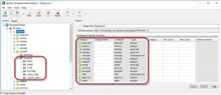

Open the newly created Output.xml in the Geospatial Administrator and review the results.  Each shapefile is created as a single feature with properties found in their respective DBF file.
At this point, you can edit the symbology, rename properties as needed, and perform other house-cleaning tasks to use this schema with Bentley Map.
