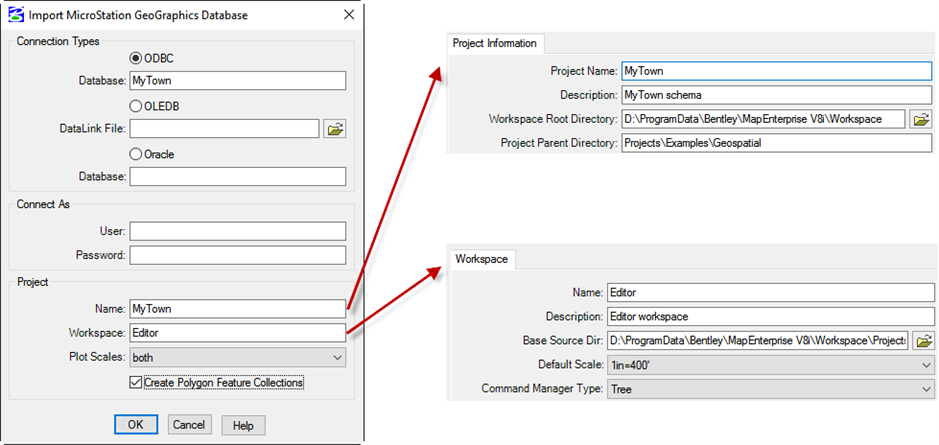

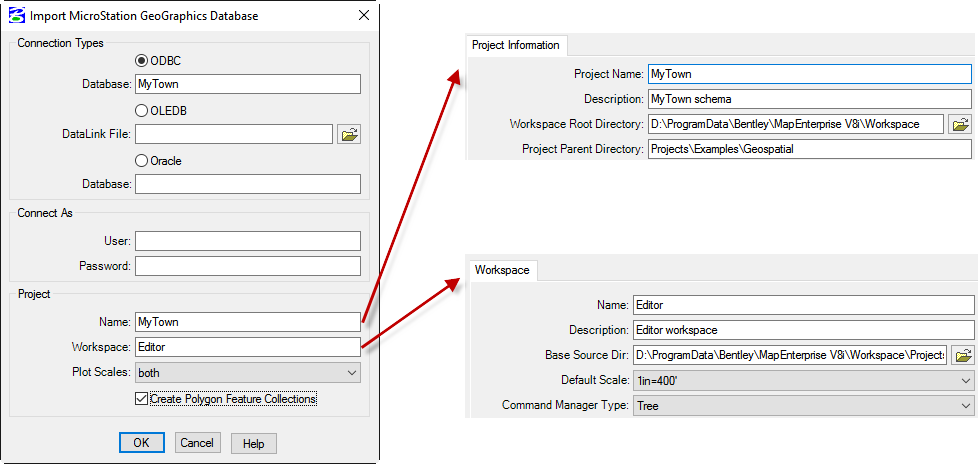

Import Modified MGE Database
To import the modified MGE database, open the Bentley Geospatial Administrator and choose File > Import MicroStation Geographics Database
The following actions are performed:
Export Workspace Metadata
When the import is complete, save and export the workspace metadata. This creates the necessary folders and files in order for Bentley Map to operate.   Running Bentley Map with the new workspace will indicate the following:
