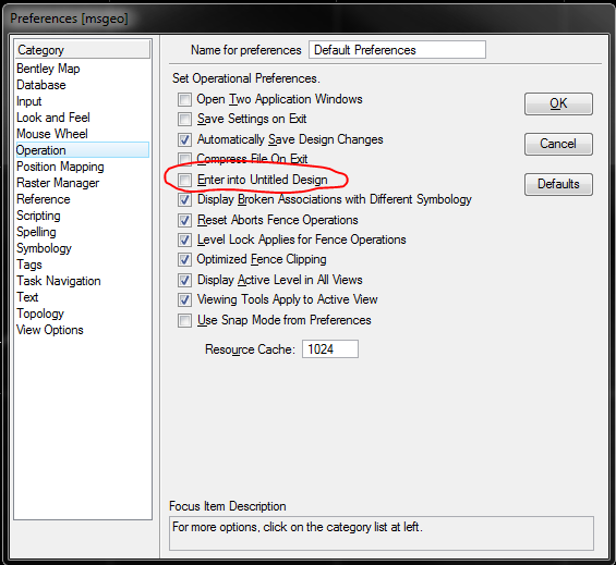

 By default, PowerMap starts in an untitled DGN and without the option to set the user, project or interface.
To change this:
1. Open the untitled design once
2. Go to Workspaces > Preferences > Operation
3. Turn off  Enter into Untitled Design
4. Press OK
5. Close file
The next time PowerMap is started, the standard File Open dialog will appear.
