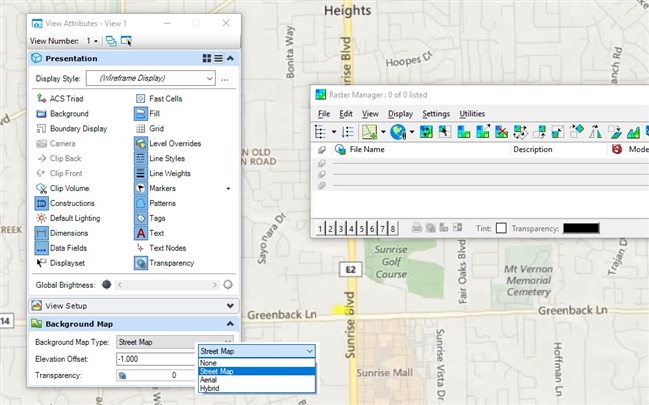

Then assign the new key value to the configuration variable MS_RASTER_BINGMAP_KEY.
Note:  The CONNECT Edition supports Bing Maps without the need for a key.  Bing maps can also be set as a background map via the View Attributes dialog which eliminates the need for attaching it as a raster reference.
