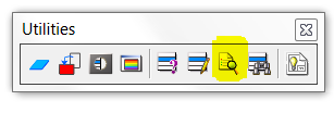

Problem:  Data browser does not open when icon is selected.  There are no error messages, and it happens with every file
1. Open Bentley Map
2. Go to Tools > Geospatial > Utilities
3. Click on the Data Browser icon.
4. If it does not appear, go to the Window menu and select it from the drop down list.
5. If it still does not appear, make sure the dialog in question has focus (by selecting in Windows menu).
6. Press ALT + SPACE and the context menu should appear for the dialog.
7. Press M or select Move using the mouse (this may be different for foreign languages).
8. Use the arrow keys on the keyboard to move the dialog into view (try all directions until outline of dialog appears).
