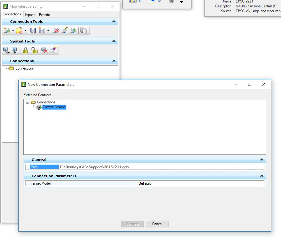

Problem: You receive a File geodatabase from your client but the connection in Bentley Map does not show any Layers.

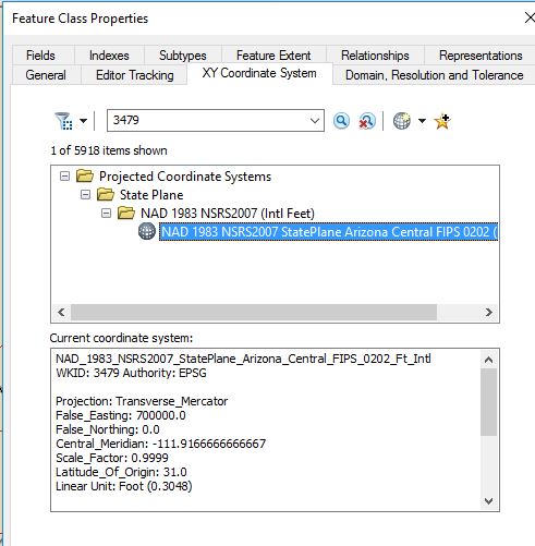

Resolution: Set the Spatial Reference in ArcCatalog to a standard coordinate system so that it will be visible in MicroStation as a valid coordinate system.

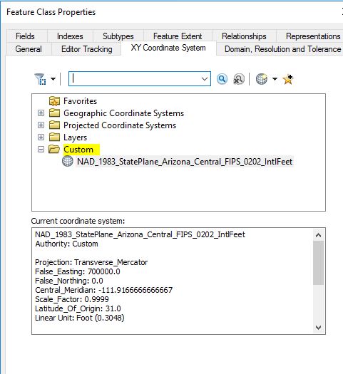

The ArcMap layer is defined with a Custom coordinate system.
To be used in other applications, the Custom coordinate system for each ArcMap layer is should be redefined with a standard coordinate system.

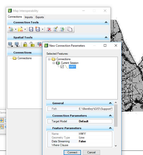

Once the ArcMap layer is defined with a standard coordinate system, it can be seen in other applications such as Bentley Map, as-shown here.
