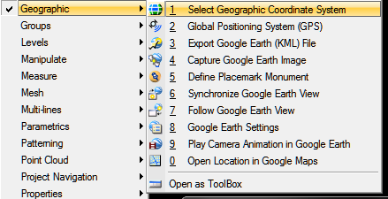

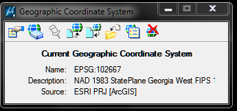

2.)    Define Coordinate System (Tools > Geographic > Select coordinate system)

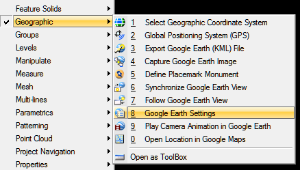

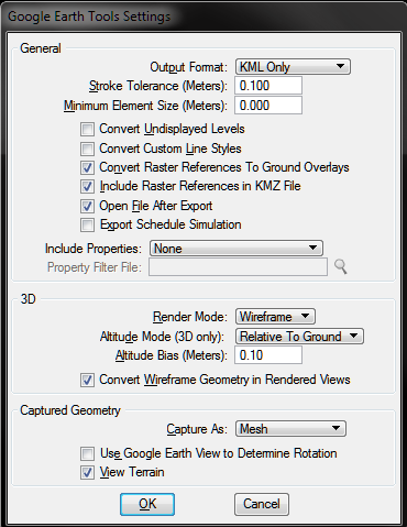

4.)    Turn On View Terrain
a.       Tools > Geographic > Google Earth Settings

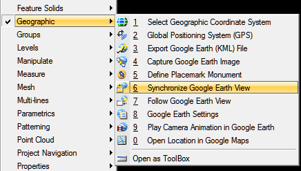

5.)    Tools > Geographic > Synchronize Google Earth View
a.       NOTE:  You may have to do the Synchronize command twice for Google Earth and area to display

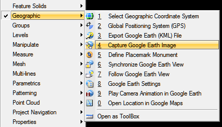

6.)    Tools > GeoGraphic > Capture Google Earth Image ( This will show wireframe)
a.       NOTE:  If you do not have an Active Level defined you will not get the Wireframe.  If you have View Attribute set to Smooth you will get a gray image.
