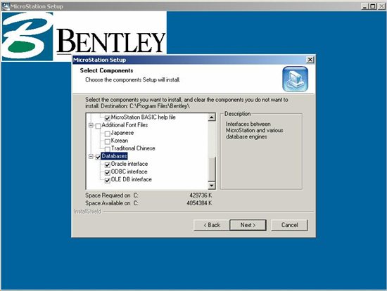

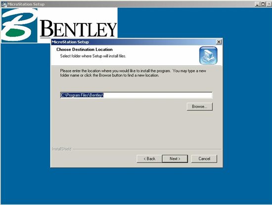

When installing MicroStation:
-Select a new or empty directory for the installation.
Installation over a previous version can cause conflicts with pre-existing settings and configuration files when programs such as GeoGraphics are used.
Figure 1
-Include the MicroStation Databases component when installing.
If utilizing a pre-existing copy of MicroStation, check to ensure that databases have been installed by locating the folder:
...\Program\MicroStation\database\
This folder should include at least the ODBC subdirectory, as a Microsoft Access *.MDB file will be utilized in this example as the database connection.

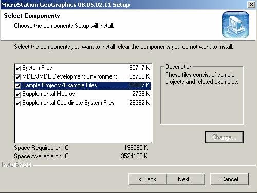

When installing GeoGraphics:
-As multiple copies of MicroStation may exist on a system, GeoGraphics will attempt to install to the location of the most recent MicroStation installation. Be certain that you are installing to the desired location.
-Include the GeoGraphics Sample Projects/Example Files component.
Figure 3

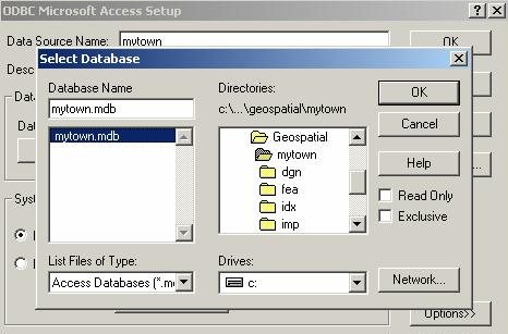

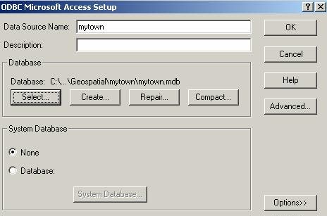

- Input the ‘Data Source Name' as ‘mytown' [We use ‘mytown' because the GeoGraphics icon titled "MicroStation GeoGraphics Mytown (ODBC)" (see Figure 4) is preconfigured to look for this DSN.]
- Click Select and browse to the delivered mytown.mdb file:
....\Bentley\Workspace\Projects\Examples\Geospatial\mytown\mytown.mdb
Figure 6
- Click OK to complete the definition.

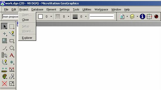

Launch the mytown project by clicking the "MicroStation GeoGraphics Mytown (ODBC)" icon.
The design file ‘work.dgn' is loaded and the project opens automatically.
Note: If a project is opened with the ‘Work Map' toggle engaged, the software will attempt to overwrite "work.dgn". Be sure that you do not overwrite the file in this process. You should "save as" a different name to prevent this.
To confirm that the project has opened, select the GeoGraphics ‘Project' menu. The ‘open' option is disabled, indicating that the project is in the open state.

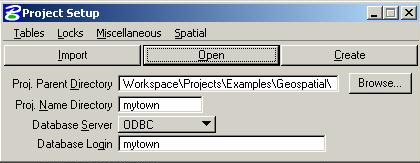

- Select Project->Close to close the project.
- Select Project->Setup.
- Click Open in the Project Setup interface.

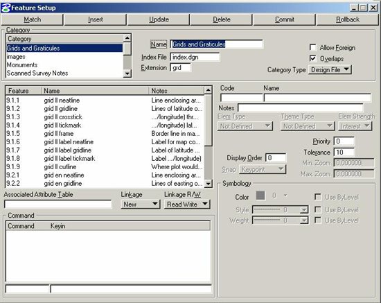

- Select Tables->Feature Setup.
Figure 10

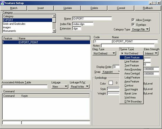

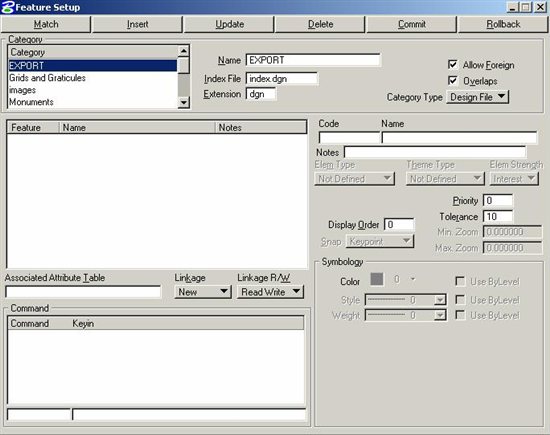

The Feature Setup dialog box shows us that features are grouped within categories. The broader purpose of the category/feature relationship is beyond the scope of this article. Refer to your GeoGraphics documentation for more information about that topic.
We will create one category specifically to contain five features to be used for export.
- Select the existing category ‘Grids and Graticules'.
- Overwrite the displayed category name and enter ‘EXPORT' as the new category name.
Figure 11
- Overwrite the displayed category extension and enter ‘dgn' as the new category file extension.
- Toggle on the ‘Allow Foreign' option.
- Click the ‘Insert' button to create the new category.
Figure 12

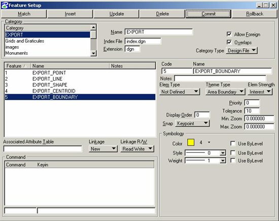

Create a new feature by populating the ‘Feature' section of the dialog box:
- Enter 1 as the (feature) Code.
- Enter ‘EXPORT_POINT' as the (feature) name.
- Click Insert to create the new feature.
- Modify the feature's Theme Type to Point Feature.
- Set the line weight of the Feature to 4
- Click Update to update the feature with your changes.
Figure 13
Create the remaining features using the following specifications:
FEATURE CODE : 2
NAME: : EXPORT_LINE
THEME TYPE : Line Feature
COLOR : 1
WEIGHT : 1
FEATURE CODE : 3
NAME: : EXPORT_SHAPE
THEME TYPE : AREA Feature
COLOR : 2
WEIGHT : 1
FEATURE CODE : 4
NAME: : EXPORT_CENTROID
THEME TYPE : AREA CENTROID
COLOR : 3
WEIGHT : 4
FEATURE CODE : 5
NAME: : EXPORT_BOUNDARY
THEME TYPE : AREA BOUNDARY
COLOR : 4
WEIGHT : 1
Figure 14
When finished, click Commit to save your changes to the database and close the Feature Setup and Project Setup dialog boxes. Stay in the MicroStation GeoGraphics session.

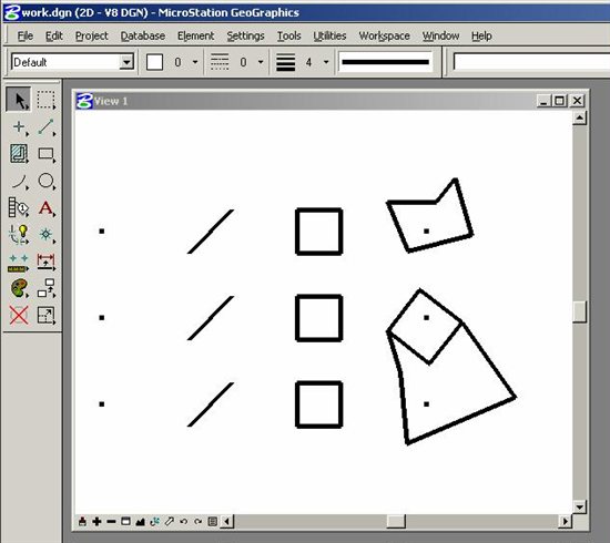

Create the following elements in whatever manner you are comfortable with. (Ensure that no other elements exist within these shapes.) In this example we will create three of each, and will list the associated MicroStation key-in command (Utilities->Key-in):
POINT (Key-in: PLACE POINT)
LINE (Key-in: PLACE LINE)
SHAPE (Key-in: PLACE SHAPE)
Figure 15

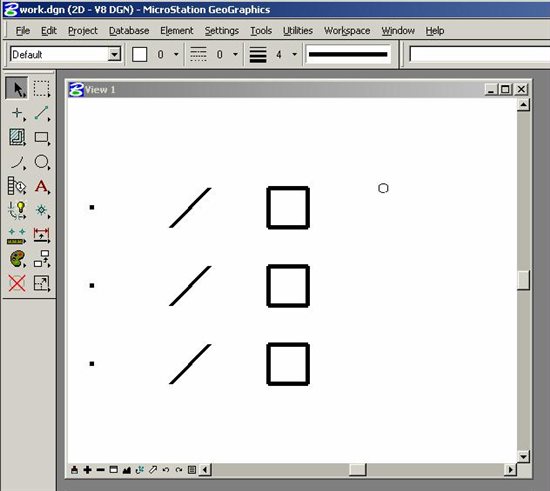

Continue by creating three polygons, made of line elements.
Within these polygons, place one point each. These parcel-style areas may be contiguous.

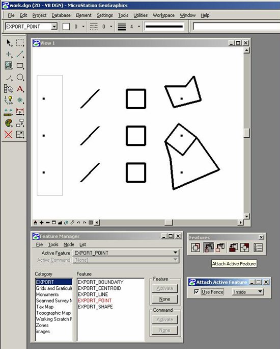

When we featurize an element with GeoGraphics, we are actually creating a database linkage on the element from the GeoGraphics project's feature table.
We'll first featurize the points.
- Place a fence around the elements to be featurized.
- Open the GeoGraphics Feature Manager (Utilities->Feature Manager).
- Locate and select the EXPORT category.
- Double-click EXPORT_POINT feature to make it the active feature.

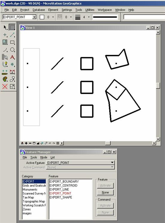

You will notice that the Active Level has become EXPORT_POINT.
Figure 17
- Open the GeoGraphics Features tool frame
- (Tools->GeoGraphics->Features)
- Select the Place Active Feature tool.
- Toggle on the Use Fence option from the MicroStation tool settings dialog.
Figure 18
- You are prompted to Attach Feature to Fence Contents...
- Place a datapoint in the view to accept.
Repeat the operation for the lines and shapes, activating the Feature EXPORT_LINE for each line and EXPORT_SHAPE for each shape.
To assign the features EXPORT_CENTROID and EXPORT_BOUNDARY, create a selection set of the elements to be featurized. Untoggle the Use Fence option when the Attach Feature tool is activated.

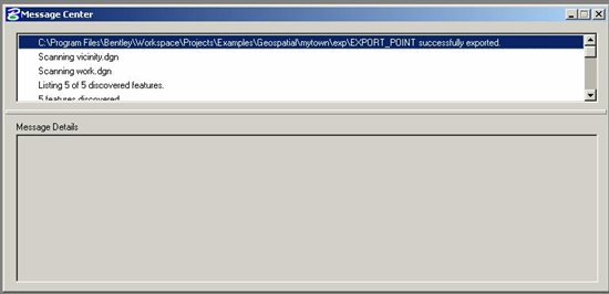

- Click Export, and GeoGraphics creates the shapefiles. Confirmation of export success will be displayed at the bottom of the program window within MicroStation's Message Center. If you want to view the message history, double-click the message area to expand it.
Figure 21

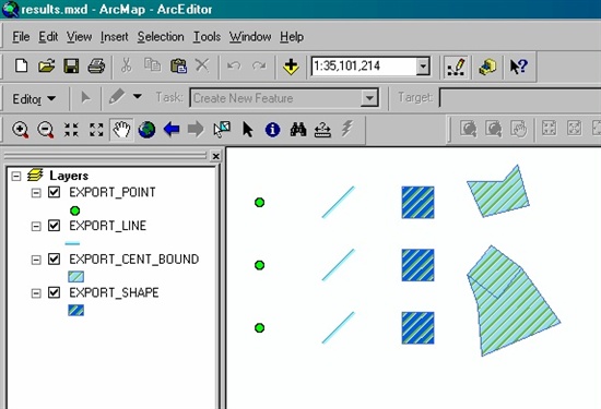

Viewing resulting data
Graphics
Results can be re-imported into MicroStation to confirm that the desired results were obtained, or can be viewed using ESRI's free ArcExplorer download (http://www.esri.com/software/arcexplorer/index.html) .
(The following figures are from ArcMap.)
Figure 25

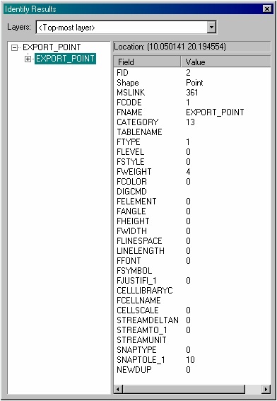

Attribute data
Since the ESRI shapefile format requires each element to have an attribute linkage, we see that the elements' feature linkage information is used for the attribute record exported to the *.dbf file component of the shapefile. (See figure 26.)
Figure 26
