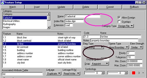

SCALE DEPENDENT VIEWING
In the ugfeature table the columns zoommin, zoommax (long integer or number (38)) are used for setting the scale-dependent viewing. When these columns are available, the fields Min. Zoom and Max. Zoom are enabled in the Feature Setup dialog box. It is the width or height of a view in master units that determine whether a feature is displayed or not.

Using the minimum bounding rectangle (MBR)
Instead of storing the surrounding of a map in an index file, the range of a map can be stored in four columns in the maps table. The columns xlow, ylow, xhigh and yhigh (long integer number(38)) can contain the range of a map in sub units and not master units (or in uors for v7 design files).
In the Category section of the Feature Setup, the field Index can be left empty. In this case, the Register tool fills these columns.

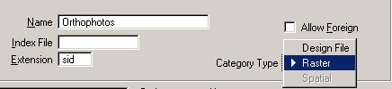

Since MicroStation GeoGraphics v7.2 there are three different category types. Design File, Raster and Spatial.
To enable all three options in the raster column in the ugcategory table must be a long integer (for Access) or number(38) (for Oracle).
