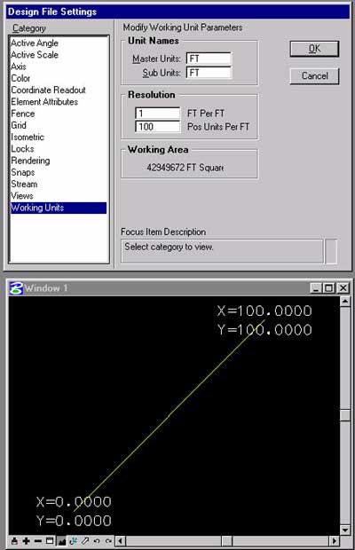

Set up a new file within a pre-V8 version of MicroStation
Label the master unit ‘FT'
- Settings -> Design File -> Working Units
Create a line from ‘0,0' to ‘100,100' via the Key-in window.
- Place Line; xy=0,0; xy=100,100
If you choose, label the end points using the XYZtxt Label Points tool.

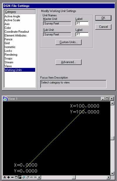

Edit the delivered units.def example for your MicroStation V8 installation, and enable the ‘Survey Foot' record by removing the preceding # symbol. The resulting line will appear as follows:
FT,ft'; Survey Foot; Survey Feet; 3937.0; 1200.0; 1; 1

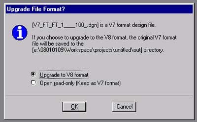

Open the pre-V8 file using MicroStation V8 and choose to upgrade the file to the V8 format.
The units.def file's ‘FT' label definition will be engaged, and the resulting Master Unit name and label will be "Survey Feet FT."
( Snapping to the end points of your line will reveal that the coordinates are in fact 0,0 survey feet and 100,100 survey feet, respectively.

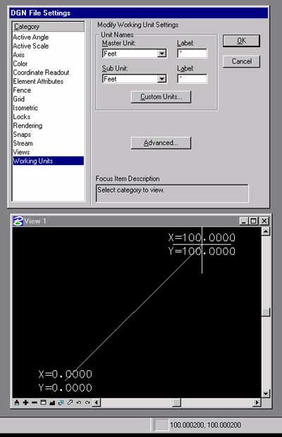

If, instead, your pre-V8 label represented International Feet, we can observe the error by changing the Master and Sub Unit within the file.
Use the Settings->Working Units dialog or key in: set units "Foot"
Snap to each end point of your line and notice that the readout for 0,0 remains constant, but that the opposite end of the line has become 100.000200,100.000200 International Feet.
