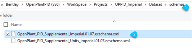

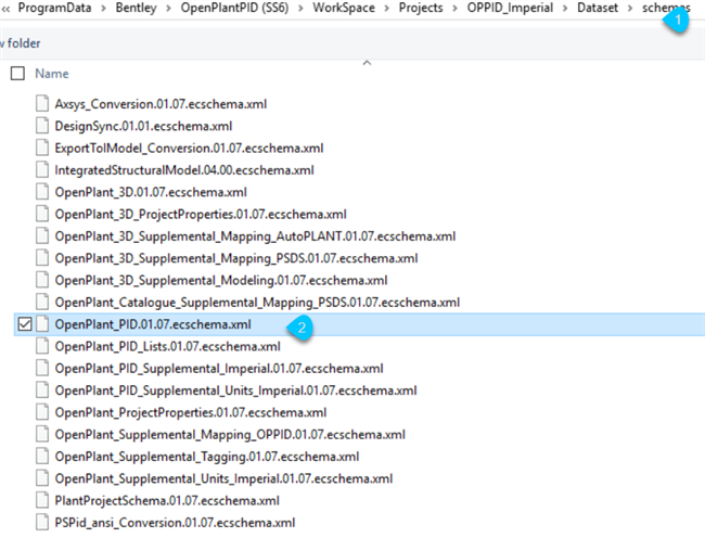

The Actuator list is located in the supplemental files.
  These files are located in the Workspace folders of a particular project.

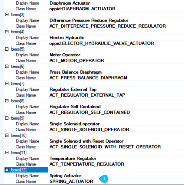

  1. Open Class Editor and open the Project EcSchema you wish to modify. In this example we will be working with the ISO EcSchema.
  2. Search for "ACTUATOR_LIST" class.
  3. Right click on Items and select Add Element. In the blank element section that is added at the bottom add the following:
    1. DISPLAY_NAME value = Spring Actuator
    2. CLASS_NAME value = SPRING_ACTUATOR
    Refer to Screenshot below:
<CLASSNAME_DISPLAY_STRUCT>
   <DISPLAY_NAME>Spring Actuator</DISPLAY_NAME>
   <CLASS_NAME>SPRING_ACTUATOR</CLASS_NAME>
</CLASSNAME_DISPLAY_STRUCT>

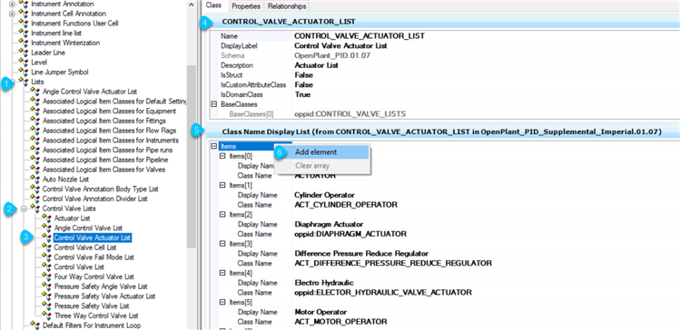

 Case II.
In second case it is shown that how to add New Actuator List in OpenPlant PID SS6 Version.
  1. Launch Bentley Class Editor.
  2. Open OpenPlant_PID.01.07 schema
  3. Supplement with OpenPlant_PID_Imperial.01.07 schema.
  4. Navigate to Control Valve List, Add Element, refer below image.
  5. Enter the new value of Actuator List, refer below image.
  6. Save all Changes.
  7. Launch OpenPlant PID & Verify result.
