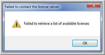

Select here if "Failed to retrieve a list of available license" message appears:

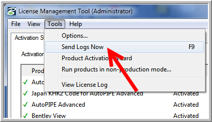

Step #2: Send logs now by using one of the following options
After initiating this command,  the application will be sending log information back to the Bentley hosted server, wait just a moment for the light show to stop. At this point the product listing will be refreshed with the latest SELECTserver information.
Option #1: Select Tools> "Send Logs Now"
Option #2: Press F9 button on your keyboard  (generally located on the top row of a keyboard),
