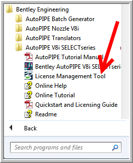

Start LMT by using one of the following methods:
Option #1: Using the Windows Menu
Get to a Windows Start button,
Win 7 : Select  Start button> All Programs> Bentley Engineering> AutoPIPE> License Management Tool

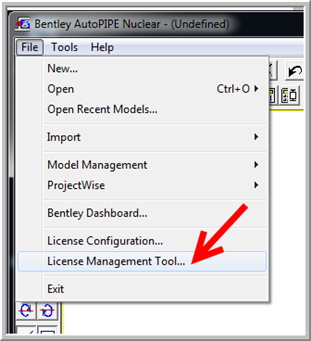

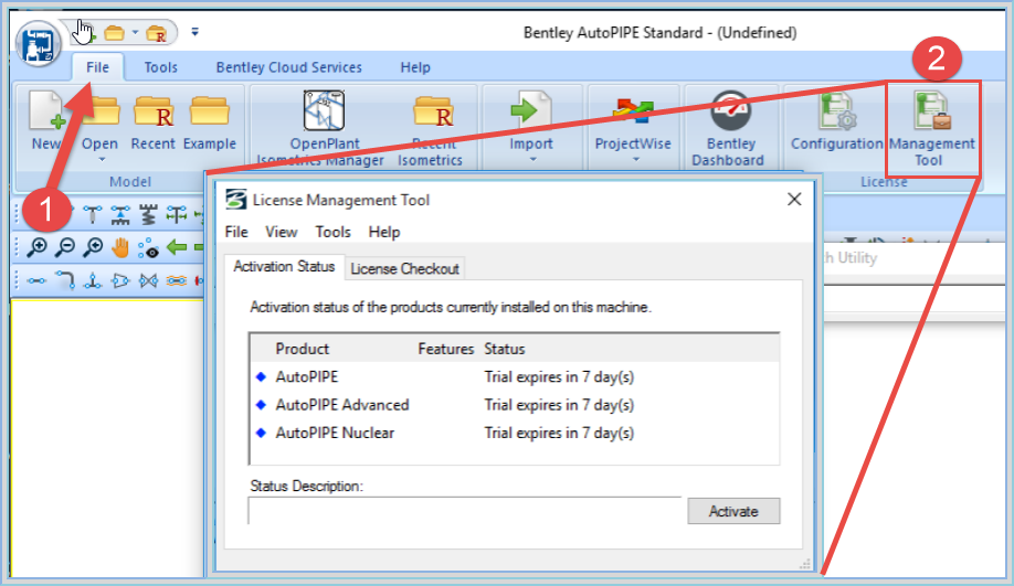

Option #2: From within the application
Using AutoPIPE CONNECT 11.xx and higher
Select File> License Management Tool>
Using AutoPIPE V8i 09.06.01.10 to 10.xx

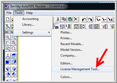

Using AutoPIPE XM 08.09.xx.xx to V8i 09.06.00.19
Select Tools> Settings> License Management Tool>

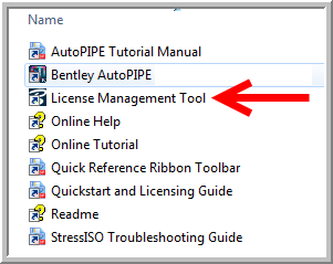

Option #4: Desktop Menu Group
Select the Desktop Icon:
        or
This will open the application group, now select the program itself from the group listing, shown below:
