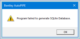

The following message appears when exporting a WORD report from AutoPIPE
Program failed to generate SQLite Database
OK
Why and how to avoid it?

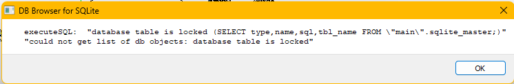

When opening the DB file does the following appear:
<pre>executeSQL:  &quot;database table is locked (SELECT type,name,sql,tbl_name FROM \&quot;main\&quot;.sqlite_master;)&quot;
&quot;could not get list of db objects: database table is locked&quot;
</pre>
OK
If no, continue below.
If yes, click here.
Avoidance:
First try to recreate the output report again. If the error message appears again, after 3 tries one or more of the following should resolve the issue:
1. Check that the path name and file name does not contain non-ascii character. Try saving the model as Test.dat to a new folder on the desktop, run an analysis, and create a complete report.
2. Review all component tag fields and Attachment ID fields, nothing can be start with a quote (1116320), example "B" OUTLET NOZZLE, suggested change OUTLET NOZZLE "B".
3. There may be one or more sub-reports having an issue, perform the following:
a. Analyze the model
b. Create a model input listing report. move only one report from the Available column on the left to the Selected Reports column on the right. and Press OK.
c. Regardless of the report being created or not, open the Model Input listing report dialog again, remove the report from the right column and add the next report from the left column to the right. Again press OK to try and create a report.
d. Repeat step above for all available reports. and document reports that were unsuccessful created (ex. Anchor).
e. Knowing which report(s) were not created, remove all of those components from the model (ex. If Anchor report was not created, delete all anchors from the model)
f. After deleting all components, try and re-run the analysis and create again a complete model input listing.
g. Try to reinsert the deleted components into the model, re-run the analysis, and create again a complete model input listing.
4. Open computer Virus protection program and add AutoPIPE as an authorized application or exception.
5. Confirm decimal character was set to a "." dot. For instructions to do this, google "change region decimal character" .
6. "Run the application as an Admin" - right clicking on AutoPIPE icon to start the program, select Properties, and select " Run as Admin". repeat steps above.
7. Reboot the computer and try again.
8. If "Results database file not found" message appears after this message, see KB article here. Otherwise, continue below.
9. If a PXF file is imported with ISO 14692 selected as the piping code, this issue may occur. The behavior has been identified as a product defect and logged as Bug 1697768 – “PXF import aborts when ISO 14692 piping code is selected.” Until this issue is resolved in a future AutoPIPE release, it is recommended to avoid importing PXF files directly with ISO 14692 selected.
As a workaround, import the PXF file using an alternative piping code, then once the model opens successfully in AutoPIPE, manually update the General Model Options to select ISO 14692 and the required code year.
Note: If the the message above appears, try again to generate a report. IF the problem continues, log a Bentley Service Request and send in your model APC file for review.
