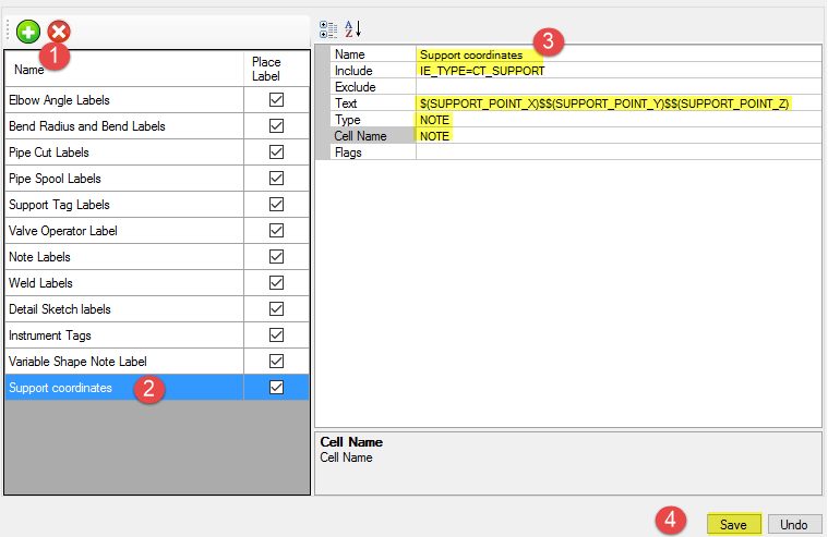

In OpenPlant Isometrics Manager, below steps describes placing annotations on Supports. Follow the steps below to add the annotations of support co-ordinates in the Isometric.
- Launch OpenPlant Isometrics Manager.
- Open Isometric Configuration dialog. Go "Isometric Style" tab.

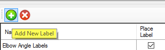

- Click "User Labels" > and click on "+" Symbol to add a new user label.
- Input the new user detail as below picture.
Name Support Coordinates
Include IE_TYPE=CT_SUPPORT

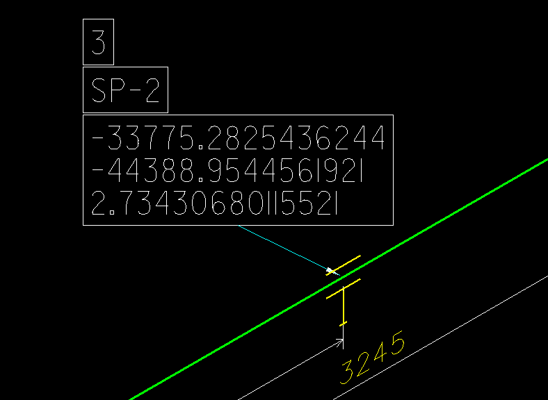

Text $(SUPPORT_POINT_X)$$(SUPPORT_POINT_Y)$$(SUPPORT_POINT_Z)
Note -Extra Dollar Sign "$" put the labels in next row
Type NOTE
Cell Name NOTE
- Notice, the Iso includes support co-ordinates. See image below.

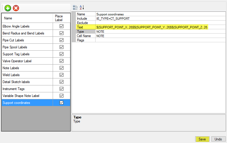

With SS6 ( 08.11.11.87 ) version, user can use Format specifier, to suppress the coordinates with precision.

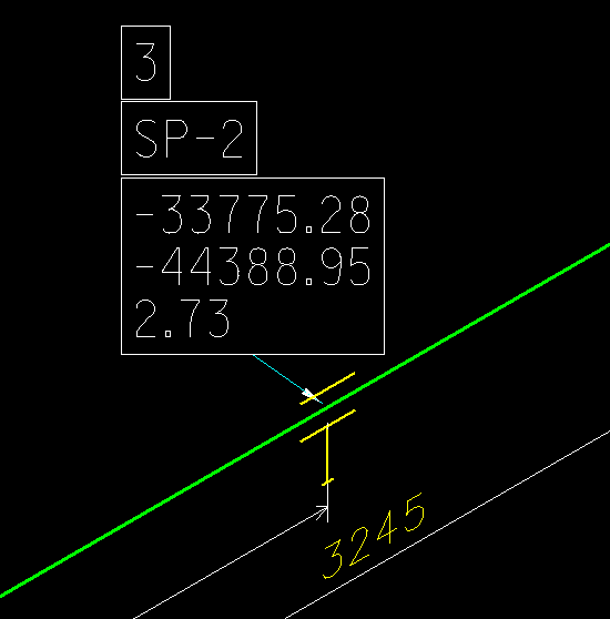

Text $(SUPPORT_POINT_X:.2f)$$(SUPPORT_POINT_Y:.2f)$$(SUPPORT_POINT_Z:.2f)
Note -Extra Dollar Sign "$" put the labels in next row. Specifier PROPERTY:.2f produces 2 digit after decimal. To check more options, click here>>>
Type NOTE
Cell Name NOTE
- Generate Isometrics and verify results below:
