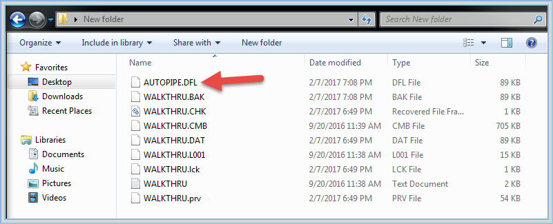

AutoPIPE has a feature to save some default settings, however where exactly is this file saved too?

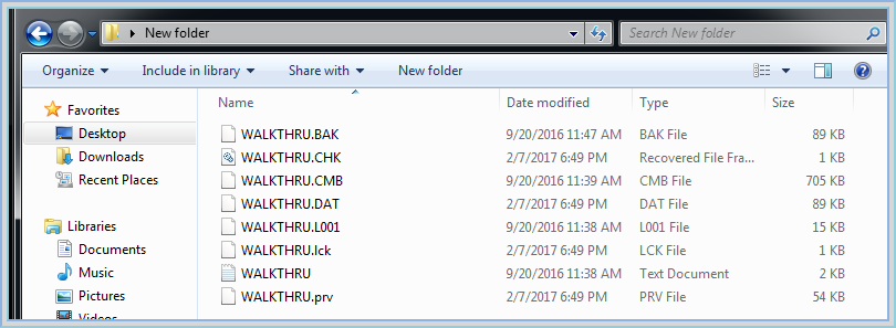

 Saving an AutoPIPE model to a new folder creates a series of files, shown below:

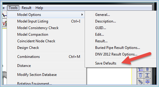

As the program is used additional files are created and saved to the same folder where the model DAT file was located. Like wise, using SAVE Defaults command
an AutoPIPE.DFL file is saved to the same folder as the current model being modified is located:
See AutoPIPE help for complete details on this feature:
Help > Contents> Search Tab> enter "Save Defaults" (include the quotes),
press List Topics button, double click on the selected topic from the list provided "Save Defaults" to see more information.
