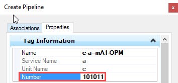

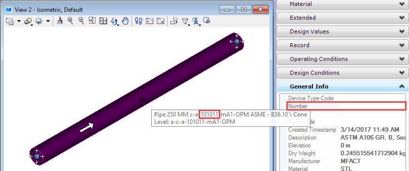

While creating PIPELINE in OpenPlant Modeler we input number in the NUMBER property in Tag Information
but that number property is not visible on the segments. NUMBER property shows null value under General Info in Element Info dialog.

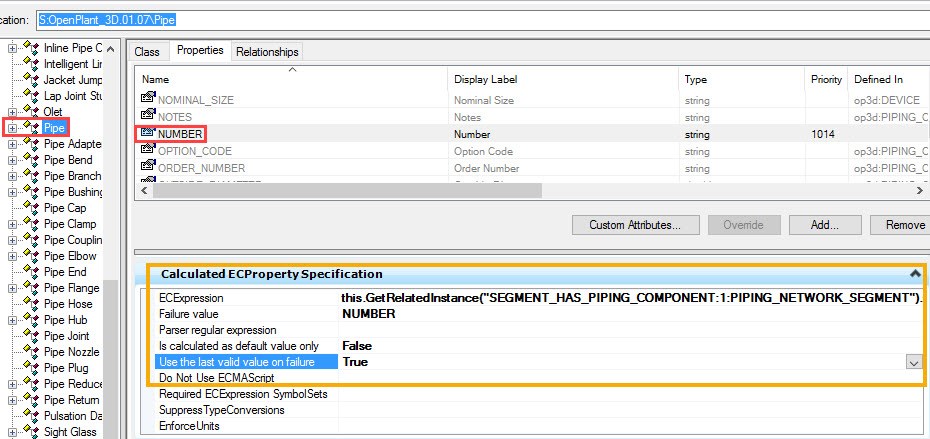

Modification required in Schema
  1. Load OpenPlant_3D.01.07 schema in class editor and supplement with OpenPlant_3D_Supplemental_Modeling.01.07 schema.
  2. Go to NUMBER property of PIPE class and add Calculated EC property Specification custom attribute and add the following EC expression in it.
    this.GetRelatedInstance("SEGMENT_HAS_PIPING_COMPONENT:1:PIPING_NETWORK_SEGMENT").GetRelatedInstance("PIPELINE_HAS_SEGMENT:1:PIPING_NETWORK_SYSTEM").NUMBER
  3. Save the changes and test.

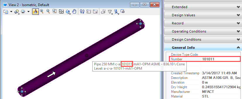

  2. Create New Pipeline, input number in the NUMBER property in Tag Information and place a pipe segment.
  3. Check the Number Property under General Info category in Element Information dialog.
