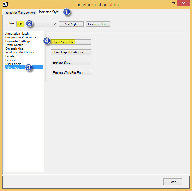

  1. Launch OpenPlant Isometrics Manager.
  2. From Configuration dialog box, Click on "Open Seed file" from ‘Advanced’ option. See image below.
  3. Use Key-in command, available in ‘Utilities’ option.

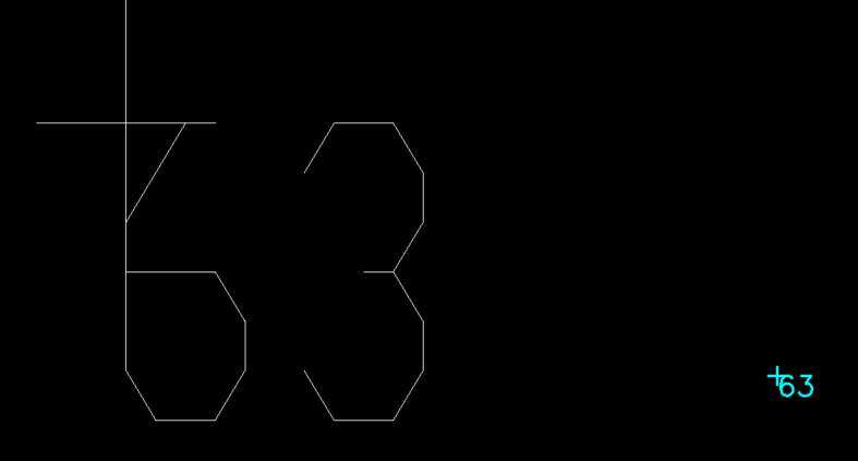

  4. Enter Value NN=61. If this is the desired value. See Image below.
  5. Press ‘ENTER’.
  6. Start Placing text node. It will again start the counting from Node 61.
    Note- Please take care about placement, due to default scale setting it might appear short and negligible. See image below.
