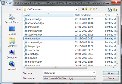

  3. Select Elbows.dgn file to modify.
    Note: For Tee/Support you may select Branch/Support dgn file.

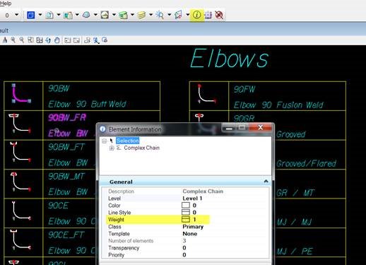

  4. Select required type and change the weight through element information. See image below.
  5. Save Setting (CTRL+F).

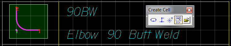

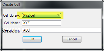

  6. Place a fence from Task menu on whole modified label and click on ‘Create Cell’ option.

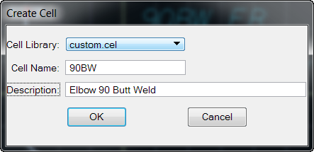

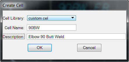

  7. It is recommended to choose the cell library to custom.cel and fill cell name and description exactly the same present for earlier one. See image below.
    Notes:

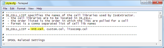

    User may create its own custom file with logical name and customize the label accordingly. To enable a new cell file type the name at first place in style.cfg in order to search the library at first, sample as mentioned in below image.
