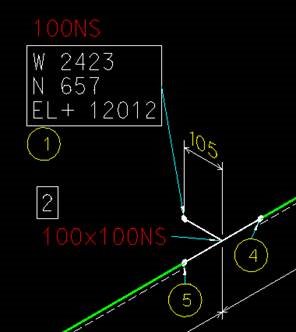

In OpenPlant Isometrics Manager, continuation label information does not appear to the connected sheet if the main/header sheet does not run at the same time. This is happening when generating the Isometrics through connecting OpenPlant Model server database. Using an I-Model by including all the lines, continuation labels appear without running the lines together.

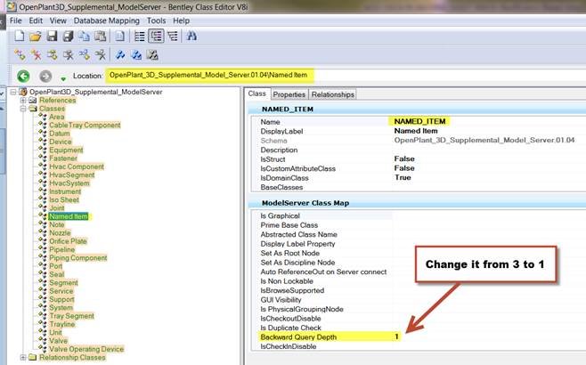

  1. Open Class Editor.
  2. Open schema “OpenPlant_3D_Supplemental_Model_Server.01.04.ecschema.xml”.
  3. Change backward query depth of NAMED_ITEM from 3 to 1. Refer snapshot below.
  4. Save the changes and close it.
  5. Check out your pipe and check in.

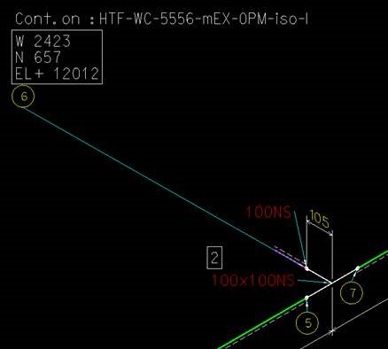

  6. Generate Iso through OPIM.
  7. You will get the continuation for pipes. See Image below.
