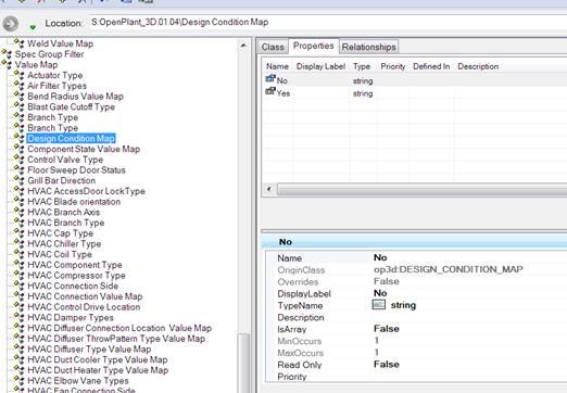

  5. Under Value Map, Create one class. Say ‘DESIGN_CONDITION_MAP and create 2 property Yes/No in it. See image below.
  6. Save & close schema mentioned above.

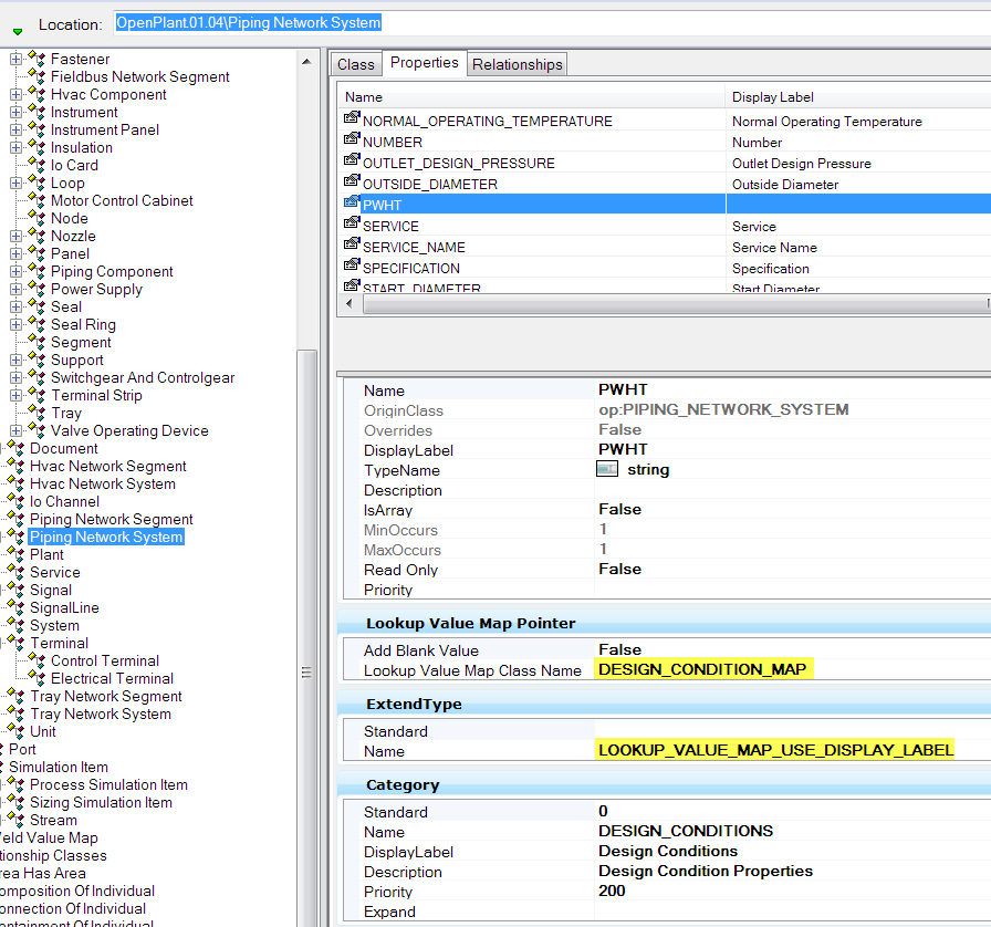

  7. Open OpenPlant.01.04.ecschema.xml Schema from Path …%Project Root%\WorkSpace\OPModeler\schemas.

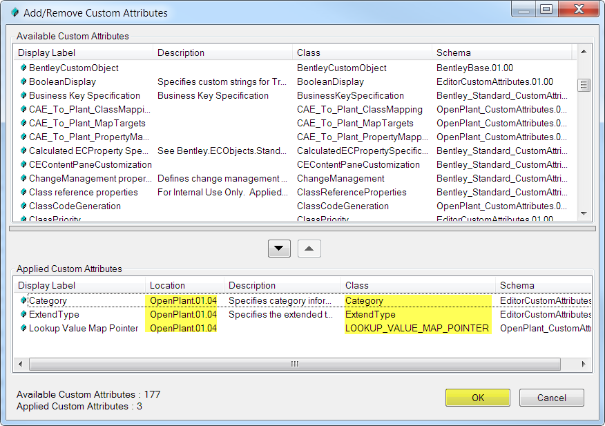

  8. Under PIPING_NETWORK_SYSTEM class, create a property say PWHT. And add CA’s as per below image.
    Note: Please Check the location for custom Attributes.

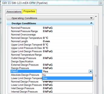

  9. Launch OpenPlant Modeler, and Place a pipe. Check Design Conditions tab, it will provide an option to pick Yes/NO. See image below.

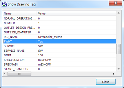

  10. Publish I model and generate isometric to verify results.
