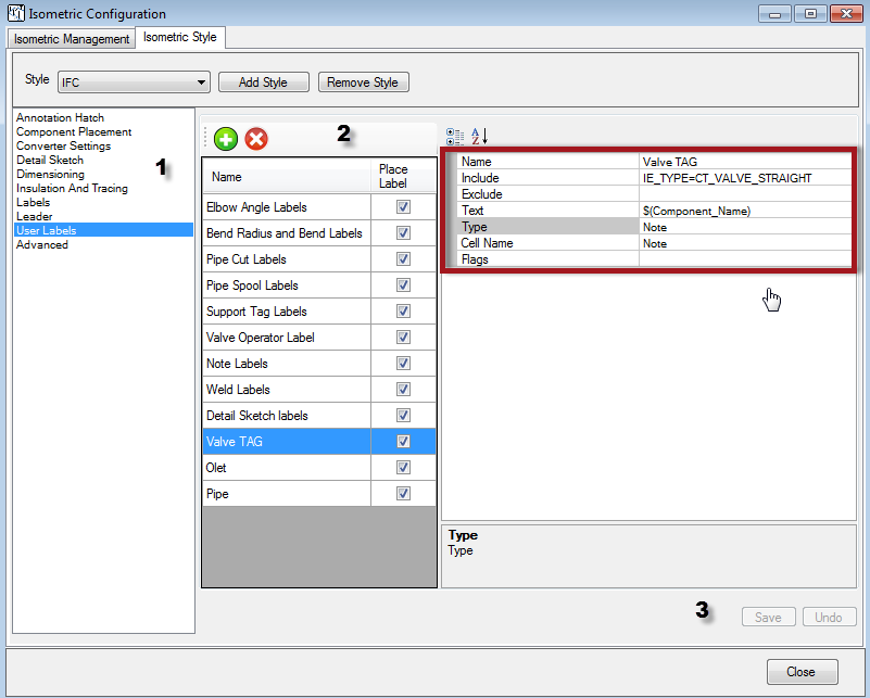

- Launch OpenPlant Isometrics Manager. Click on configuration button. See image below.

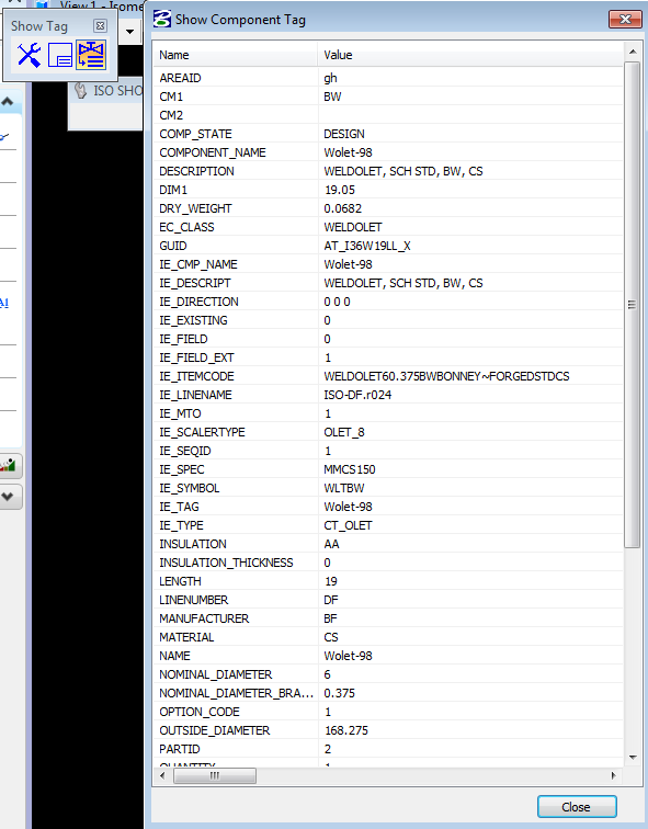

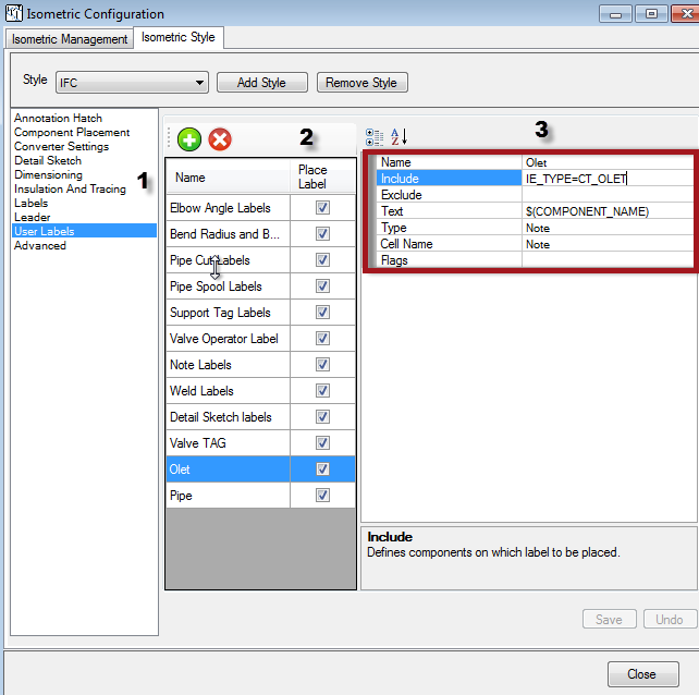

- Under ‘User Label’ tag Enter the data with steps 1,2,3, as shown in image below. Assign all the value of component attribute. Selection of the expression IE_TYPE should be done carefully to get it appear in isometrics. This can be checked and confirmed from the component tag list shown in this step later.

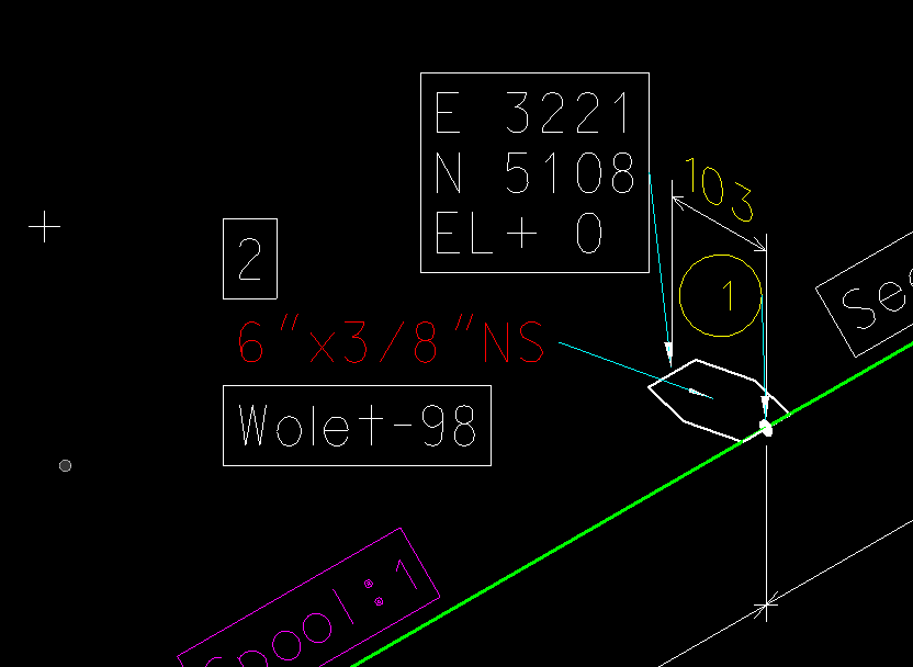

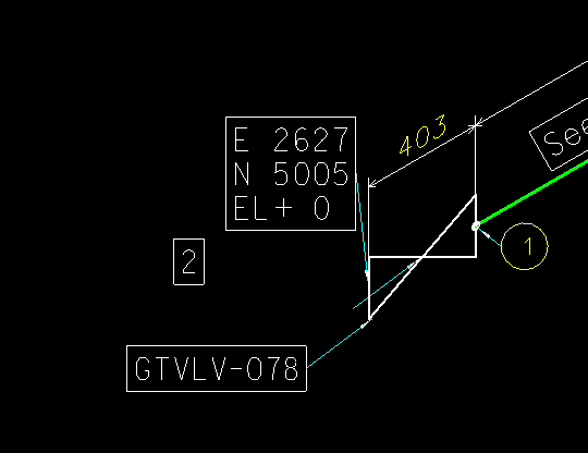

- Click ‘Save’ and generate the isometric, the IE_Component_name value will get displayed. See image below. (IE_Component_name value has been taken for reference).

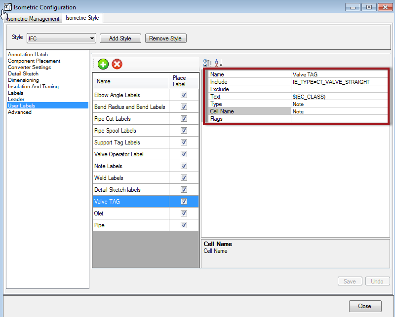

- User can also set the other component attribute value in User label dialog as per requirement. To get the component attribute information see image below for reference.
